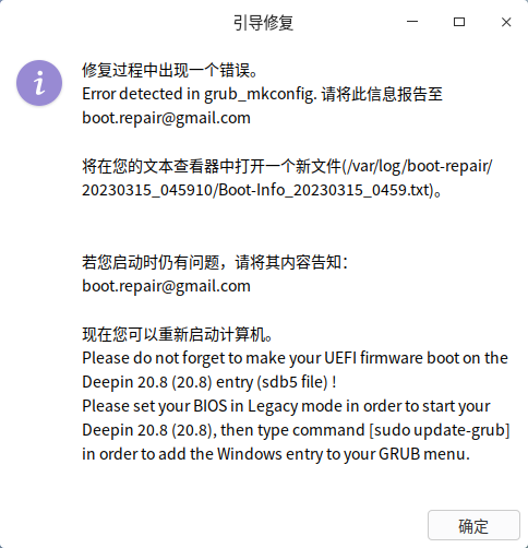

如题,继昨天的修复引导,今天我在PE用Disk Genuis又重新搞了一个ESP分区,然后我就想用boot-repair修复一下引导,结果修复失败了,大家知道这是什么问题吗?

修复过程中出现一个错误。
Error detected in grub_mkconfig. 请将此信息报告至 boot.repair@gmail.com
现在您可以重新启动计算机。
Please do not forget to make your UEFI firmware boot on the Deepin 20.8 (20.8) entry (sdb5 file) !
Please set your BIOS in Legacy mode in order to start your Deepin 20.8 (20.8), then type command [sudo update-grub] in order to add the Windows entry to your GRUB menu.

Video: Advanced Micro Devices, Inc. [AMD/ATI] from Advanced Micro Devices, Inc. [AMD/ATI]
Live-session OS is Deepin 64-bit (Deepin 20.8, apricot, x86_64)
===================================== UEFI =====================================
BIOS/UEFI firmware: 4.6.5(4.6) from American Megatrends Inc.
The firmware is EFI-compatible, and is set in EFI-mode for this live-session.
SecureBoot disabled - This system doesn't support Secure Boot.
BootCurrent: 0009
Timeout: 0 seconds
BootOrder: 0002,000A,0009,000B,0000
Boot0000* deepin VenHw(99e275e7-75a0-4b37-a2e6-c5385e6c00cb)
Boot0002* Hard Drive BBS(HD,,0x0)..GO..NO........o.Z.E.E.K.S.Y.S. .S.S.D. .1.2.0.G....................A...........................>..Gd-.;.A..MQ..L.0.2.7.1.2.0.8.0.0.A.0.0.4.7. .9. . . . ........BO..NO........o.Z.H.I.T.A.I. .S.C.0.0.1. .A.c.t.i.v.e. .5.1.2.G.B. .S.S.D....................A...........................>..Gd-.;.A..MQ..L.T.Z.1.B.1.5.K.2.2.A.0.2.3.4.D.0.P.L. . ........BO
Boot0009* UEFI: Netac OnlyDisk PMAP HD(2,MBR,0x553dc479,0x767800,0x10000)/File(\EFI\BOOT\BOOTX64.EFI)..BO
Boot000A* Unknown Device BBS(USB,,0x0)..GO..NO........i.N.e.t.a.c. .O.n.l.y.D.i.s.k. .P.M.A.P....................A.......................<..Gd-.;.A..MQ..L.N.e.t.a.c. .O.n.l.y.D.i.s.k. .P.M.A.P........BO
Boot000B* UEFI: ZHITAI SC001 Active 512GB SSD PciRoot(0x0)/Pci(0x11,0x0)/Sata(1,65535,0)/HD(5,GPT,e95a3dcd-8ae7-42c9-a239-b356562299e1,0x1c804000,0x96000)..BO
============================= Drive/Partition Info =============================
Disks info: ____________________________________________________________________
sdb : is-GPT, no-BIOSboot, has---ESP, not-usb, not-mmc, has-os, has-win, 2048 sectors * 512 bytes
sda : is-GPT, no-BIOSboot, has-noESP, not-usb, not-mmc, no-os, no-wind, 2048 sectors * 512 bytes
Partitions info (1/3): _________________________________________________________
sdb2 : is-os, 64, apt-get, signed grub-efi , grub2, grub-install, grubenv-ok, update-grub, farbios
sdb5 : no-os, 32, nopakmgr, no-docgrub, nogrub, nogrubinstall, no-grubenv, noupdategrub, farbios
sdb3 : no-os, 32, nopakmgr, no-docgrub, nogrub, nogrubinstall, no-grubenv, noupdategrub, farbios
sdb1 : is-os, 32, nopakmgr, no-docgrub, nogrub, nogrubinstall, no-grubenv, noupdategrub, not-far
sdb6 : no-os, 32, nopakmgr, no-docgrub, nogrub, nogrubinstall, no-grubenv, noupdategrub, farbios
sda2 : no-os, 32, nopakmgr, no-docgrub, nogrub, nogrubinstall, no-grubenv, noupdategrub, farbios
sda1 : no-os, 32, nopakmgr, no-docgrub, nogrub, nogrubinstall, no-grubenv, noupdategrub, not-far
Partitions info (2/3): _________________________________________________________
sdb2 : isnotESP, fstab-has-bad-efi, no-nt, no-winload, no-recov-nor-hid, no-bmgr, notwinboot
sdb5 : is---ESP, part-has-no-fstab, no-nt, no-winload, no-recov-nor-hid, no-bmgr, notwinboot
sdb3 : isnotESP, part-has-no-fstab, no-nt, no-winload, no-recov-nor-hid, no-bmgr, notwinboot
sdb1 : isnotESP, part-has-no-fstab, no-nt, haswinload, no-recov-nor-hid, no-bmgr, notwinboot
sdb6 : isnotESP, part-has-no-fstab, no-nt, no-winload, no-recov-nor-hid, no-bmgr, notwinboot
sda2 : isnotESP, part-has-no-fstab, no-nt, no-winload, no-recov-nor-hid, no-bmgr, notwinboot
sda1 : isnotESP, part-has-no-fstab, no-nt, no-winload, no-recov-nor-hid, no-bmgr, notwinboot
Partitions info (3/3): _________________________________________________________
sdb2 : not--sepboot, with-boot, fstab-without-boot, not-sep-usr, with--usr, fstab-without-usr, std-grub.d, sdb
sdb5 : not--sepboot, no---boot, part-has-no-fstab, not-sep-usr, no---usr, part-has-no-fstab, no--grub.d, sdb
sdb3 : maybesepboot, no---boot, part-has-no-fstab, not-sep-usr, no---usr, part-has-no-fstab, no--grub.d, sdb
sdb1 : not--sepboot, no---boot, part-has-no-fstab, not-sep-usr, no---usr, part-has-no-fstab, no--grub.d, sdb
sdb6 : maybesepboot, no---boot, part-has-no-fstab, not-sep-usr, no---usr, part-has-no-fstab, no--grub.d, sdb
sda2 : not--sepboot, no---boot, part-has-no-fstab, not-sep-usr, no---usr, part-has-no-fstab, no--grub.d, sda
sda1 : maybesepboot, no---boot, part-has-no-fstab, not-sep-usr, no---usr, part-has-no-fstab, no--grub.d, sda
fdisk -l (filtered): ___________________________________________________________
Disk sdb: 476.94 GiB, 512110190592 bytes, 1000215216 sectors
Disk identifier: 0323426C-B3CC-4004-9510-E4FC0D807719
Start End Sectors Size Type
sdb1 4096 125833215 125829120 60G Microsoft basic data
sdb2 125833216 251666431 125833216 60G Microsoft basic data
sdb3 251666432 461385727 209719296 100G unknown
sdb4 461385728 478167039 16781312 8G unknown
sdb5 478167040 478781439 614400 300M EFI System
sdb6 478781440 1000212479 521431040 248.6G unknown
Disk sda: 111.79 GiB, 120034123776 bytes, 234441648 sectors
Disk identifier: 5CF823AA-2C3E-4C1D-8B56-C8BF9DC370CD
sda1 2048 41945714 41943667 20G unknown
sda2 41945720 234438655 192492936 91.8G Microsoft basic data
Disk sdc: 3.73 GiB, 4008706048 bytes, 7829504 sectors
Disk identifier: 0x553dc479
Boot Start End Sectors Size Id Type
sdc1 * 2048 7763967 7761920 3.7G 7 HPFS/NTFS/exFAT
sdc2 7763968 7829503 65536 32M ef EFI (FAT-12/16/32)
Disk dm-0: 2.24 GiB, 2405969920 bytes, 4699160 sectors
parted -lm (filtered): _________________________________________________________
sda:120GB:scsi:512:512:gpt:ATA ZEEKSYS SSD 120G:;
1:1049kB:21.5GB:21.5GB:btrfs:Basic data partition:;
2:21.5GB:120GB:98.6GB:ntfs:Basic data partition:msftdata;
sdb:512GB:scsi:512:512:gpt:ATA ZHITAI SC001 Act:;
1:2097kB:64.4GB:64.4GB:ntfs:Linux data partition:msftdata;
2:64.4GB:129GB:64.4GB:ext4:Basic data partition:msftdata;
3:129GB:236GB:107GB:ext4:Linux data partition:;
4:236GB:245GB:8592MB:linux-swap(v1):Linux swap partition:;
5:245GB:245GB:315MB:fat32:EFI system partition:boot, esp;
6:245GB:512GB:267GB:ext4:Basic data partition:;
sdc:4009MB:scsi:512:512:msdos:Netac OnlyDisk:;
1:1049kB:3975MB:3974MB:::boot;
2:3975MB:4009MB:33.6MB:fat16::esp;
blkid (filtered): ______________________________________________________________
NAME FSTYPE UUID PARTUUID LABEL PARTLABEL
sda
├─sda1 btrfs 452e073b-7b19-40b5-a6ab-e14f6d6ad276 f0933b06-8b51-4ff1-a2d9-1b3a03858c77 软件 Basic data partition
└─sda2 ntfs EA003E74003E4839 e1f2a238-8600-4a78-a3ae-e763601509e5 杂项 Basic data partition
sdb
├─sdb1 ntfs 35089ED617FCC57B 92869888-ebf6-4299-9b3b-4e4c9447bed6 Linux data partition
├─sdb2 ext4 09ab1521-a90a-481b-8a92-e8dc11564343 2637238a-8772-42c9-b543-17f96a3d01ab Basic data partition
├─sdb3 ext4 f1a3d4ad-ccec-4d90-bfcc-af6417d12925 c55b136a-8884-4cdd-8047-7e8571bf2757 Linux data partition
├─sdb4 swap 779dc17a-be43-411b-a1b7-55cebbe95658 154403cd-83c9-42c8-991d-0beacc664782 Linux swap partition
├─sdb5 vfat B374-BEE4 e95a3dcd-8ae7-42c9-a239-b356562299e1 EFI system partition
└─sdb6 ext4 1309fc4a-02f7-774e-9985-6b30c25493a8 f04360a5-99ff-11ed-80cd-d48eddf6bb74 Games Basic data partition
sdc
├─sdc1 exfat E46C-E437 553dc479-01 Ventoy
└─sdc2 iso9660 2022-12-18-20-55-09-00 DEEPIN LIVE CD FULL
Mount points (filtered): _______________________________________________________
                Avail Use% Mounted on
/dev/mapper/ventoy 0 100% /run/live/medium
/dev/mapper/ventoy 0 100% /usr/lib/live/mount/medium
/dev/sda1 1.6G 91% /mnt/boot-sav/sda1
/dev/sdb1 35.8G 40% /mnt/boot-sav/sdb1
/dev/sdb2 39.8G 27% /mnt/boot-sav/sdb2
/dev/sdb3 82.4G 11% /mnt/boot-sav/sdb3
/dev/sdb6 67.2G 67% /mnt/boot-sav/sdb6
overlay 3.6G 6% /
Mount options (filtered): ______________________________________________________
/dev/mapper/ventoy iso9660 ro,noatime,nojoliet,check=s,map=n,blocksize=2048,iocharset=utf8
/dev/sda1 btrfs rw,relatime,ssd,space_cache,subvolid=5,subvol=/
/dev/sdb1 fuseblk rw,relatime,user_id=0,group_id=0,allow_other,blksize=4096
/dev/sdb2 ext4 rw,relatime
/dev/sdb3 ext4 rw,relatime
/dev/sdb6 ext4 rw,relatime

Amber
2023-03-15 21:08
/dev/sdb3是/home分区
Amber
2023-03-15 21:13
我在按照https://www.yuque.com/pzm9012/ct5ume/ihc99w手动重装GRUB时发现挂载efi分区时报错如图
心平气和
2023-03-15 21:30
Amber:
分区类型是fat32吗
云的眼泪
2023-03-15 22:08
用grub-customizer试一下
q77190858
2023-03-16 00:55
我用deepin live cd的boot-repair修复不好,用Ubuntu安装boot-repair就成功了
Amber
2023-03-16 02:02
心平气和:
分区类型是fat32吗
是的,efi分区是fat32
Amber
2023-03-16 02:03
云的眼泪:
用grub-customizer试一下
试过了,加载的时候软件就没反应了,卡死
Amber
2023-03-16 02:03
q77190858:
哈哈,这样吗?好奇怪哦
明天会更好
2023-03-16 03:08
在grub下修复好累,用live cd 启动,mount挂载系统盘硬盘,指定/boot目录,指定/boot/grub目录路径,然后sudo update-grub
