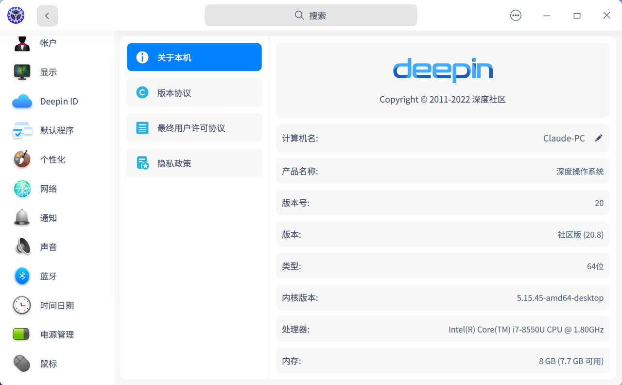

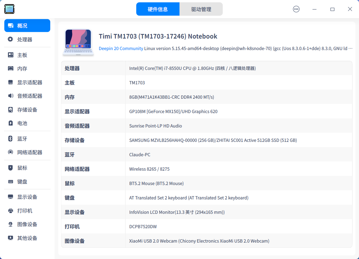

WangZhongyun
2022-12-31 18:10
先把系统信息截图贴出来
jingwei_chun
2022-12-31 19:53
jingwei_chun
2022-12-31 19:55
jingwei_chun
2022-12-31 19:57
