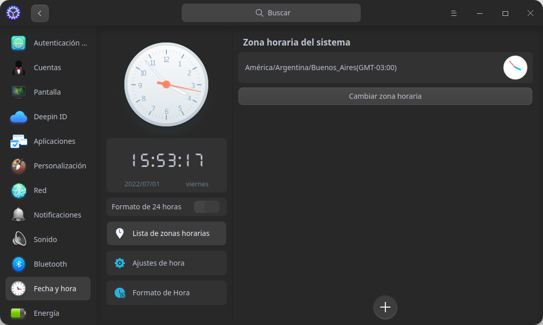

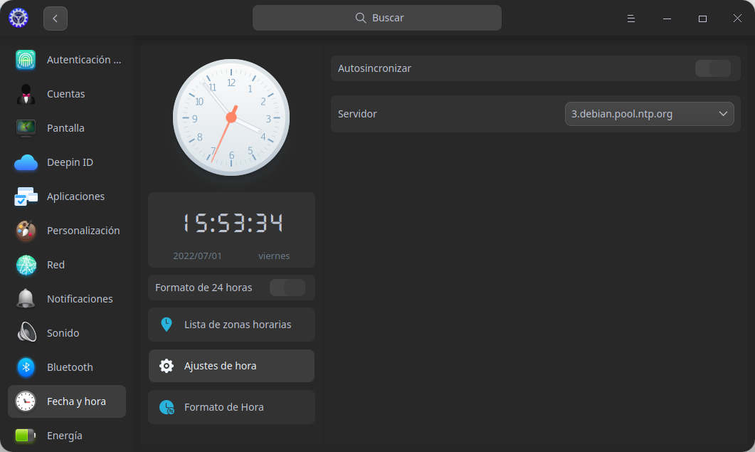

I found that notifications of calendar events, they are only notified when the system time zone configuration is GMT> = 0 , I mean time use 0 to +12 (Europe, Africa , Middle East , asia and oceania) , in half world works ok, but with the configuration of the system time zone is GMT <0 , that is, time use less than 0 , America, it does not work, that's why in Buenos Aires , Argentina GTM -3 , I never work on any device and in any version. and therefore, I had never been able to see the Calendar reminders, A SOLUTION PLEASE, THANK YOU
