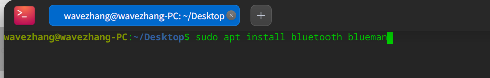

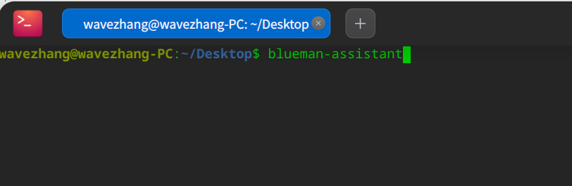

Hi Guy,
Welcome to Deepin BBS, i can fix your issue , you can follow below step on terminal ,it will help u fix your issue .
1. sudo apt install bluetooth blueman
2.blueman-assistant
restart your computer after above step. you will find it will be fine , my book also is belong to Huawei Mate Book.

哥们,你这都是小问题,用下面的步骤就能解决的
在终端里执行
2.blueman-assistant
最后重起
zerrax
2021-05-26 09:31
Dear Wavezhang66
Thank you very much for your fast reply and advise
I followed your steps and my mouse is working perfectly now.
I am very happy, thank you!
Best regards.
Zerrax
