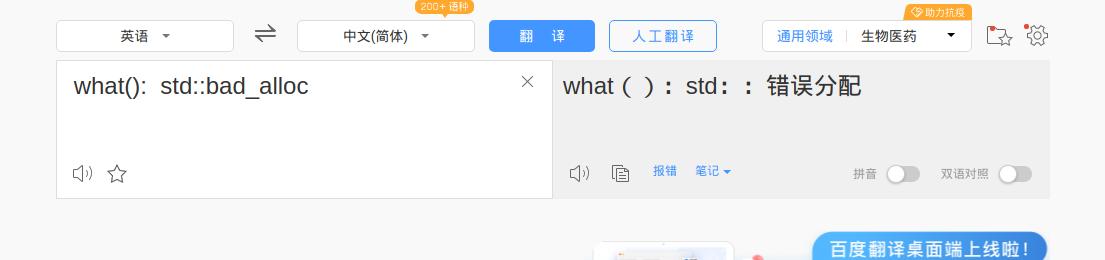

我的还是不行,终端输入dde-launcher后回显如下
terminate called after throwing an instance of 'std::bad_alloc'
  what():  std::bad_alloc
已放弃
alanjames
2021-04-23 18:31
#29
lm_2000:
已放弃
确认系统已占用内存是否正常,排除数据量过大导致的问题,此时系统内存不足导致 std::bad_alloc
网上有很多案立与方法!
https://stackoverflow.com/questions/27464617/terminate-called-after-throwing-an-instance-of-stdbad-alloc-what-stdba
等等。。。
