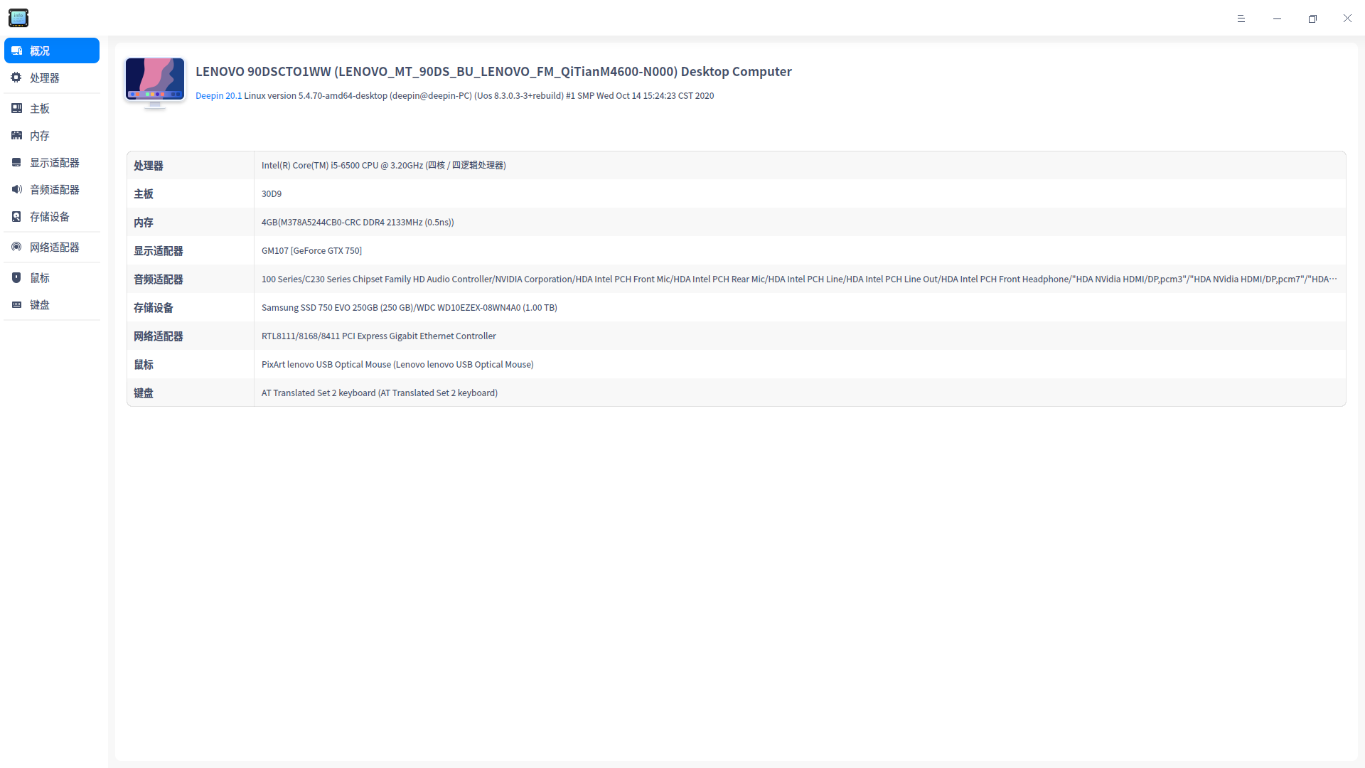

电脑配置

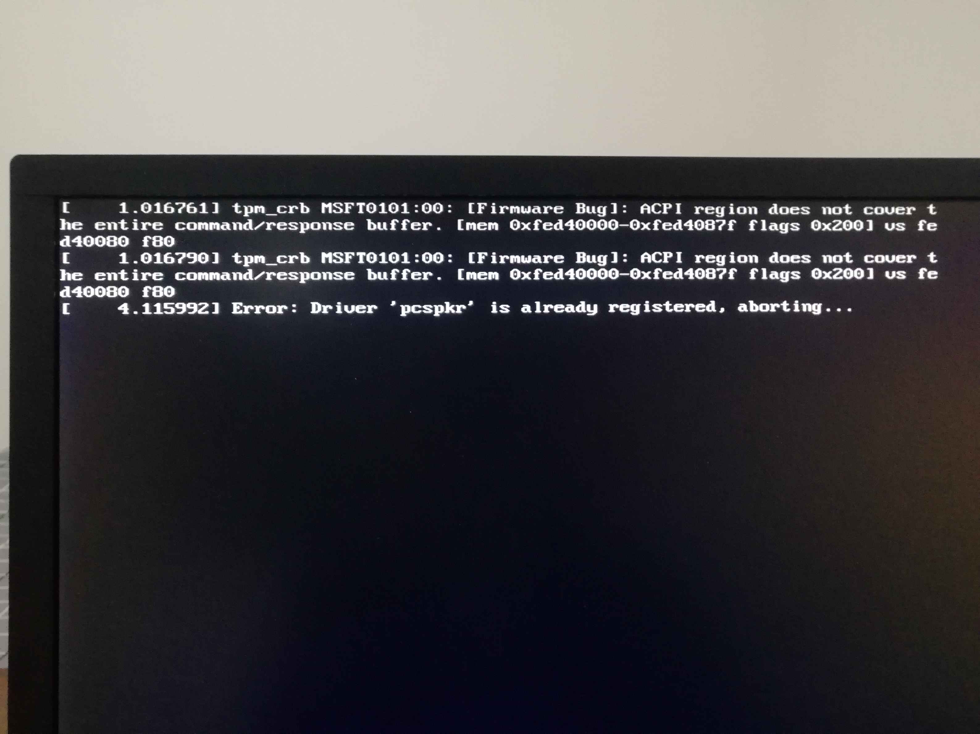

电脑配置如上图,采用全盘安装的系统,启动时显示错误
Firmware Bug:ACPI region does not cover the entire command/response buffer.
Error:Driver 'pcspkr' is already registered,aborting...
启动报错信息
请问这种问题该如何解决?

可以用gurb屏蔽tpm模块
编辑/etc/default/grub
# Written by com.deepin.daemon.Grub2
DEEPIN_GFXMODE_ADJUSTED="1"
GRUB_BACKGROUND="/boot/grub/themes/deepin/background.jpg"
GRUB_CMDLINE_LINUX=""
GRUB_CMDLINE_LINUX_DEFAULT="splash quiet nouveau.modeset=0 tpm_tis.interrupts=0"
GRUB_DEFAULT="0"
GRUB_DISTRIBUTOR="`/usr/bin/lsb_release -d -s 2>/dev/null || echo UOS 20`"
GRUB_GFXMODE="1920x1080"
GRUB_THEME="/boot/grub/themes/deepin/theme.txt"
GRUB_TIMEOUT="5"
保存执行
sudo update-grub
reboot重启

似乎没有作用

确实,看了只能换xanmod内核解决

echo 'deb http://deb.xanmod.org releases main' | sudo tee /etc/apt/sources.list.d/xanmod-kernel.list
wget -qO - https://dl.xanmod.org/gpg.key | sudo apt-key --keyring /etc/apt/trusted.gpg.d/xanmod-kernel.gpg add -
sudo apt update && sudo apt install linux-xanmod
