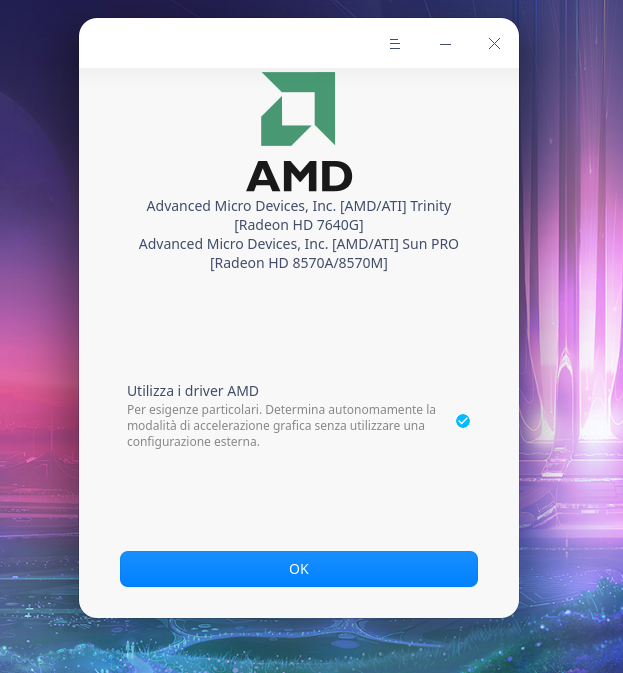

Hello I had installed deepin from iso 20 1002 and is currently updated to 20.1 1030.
After the last big update Deepin with kernel 5.4.70 does not start while I have no problems if I select the kernel 5.4.50.
I would like to try to install the last (5.11) or the penultimate Kernel (5.10.5) to try to solve the problem and I would not want to abandon Deepin.
Do you have any solution ??
THANKS
I must add that booting to USB with iso 20.1 1030 the computer freezes after a few seconds. Key fully functional on other computers.
The machine is a Lenovo G505s A8  with 8Gb RAM, dual HD 7640G and HD 8570M Radeon AMD graphics card.
THANKS
