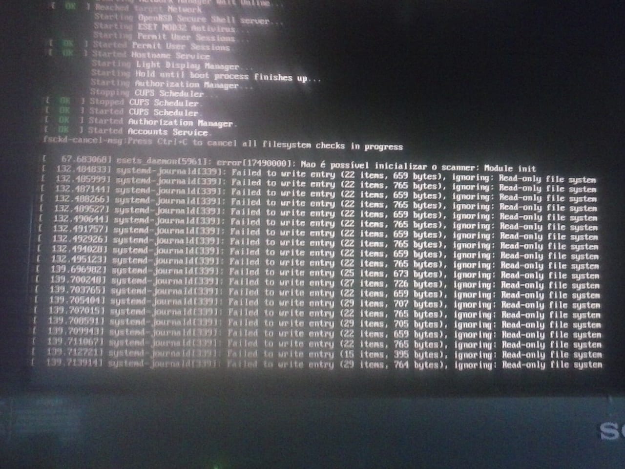

Hello Deepin Team
I still have problems when opening some applications in flatpak, it literally locks the Deepin V20 1003, where you need to manually turn off the button.
With these shutdowns there was an initialization failure, where conflict of the Eset antivirus in Deepin V20 with AV of Deepin V20 1003 can be seen.
See the generated report. I believe it can help in solving the problem.
Note:
The flatpaks that open normally and do not lock the Deepin V20 1003 are Evolution and WPS-Office.
The fatpak that locks Deepin is Keepassxc when running the application.
The manually installed firefox also crashes the Deepin V20 1003 when it runs. Should this happen?

juteman
2020-10-29 17:13
https://bbs.deepin.org/post/204279
Edited by edson1967 at 2020-10-28 11:16
Hello.
When flatpak application run, can you swtich to tty and run `top`?
is the `kwin_x11` make that cpu useage 100%.
If so, tell me your cpu infomation and gpu infomation
edson1967
2020-10-30 19:32
Hello @juteman
Answer: I can't. Everything locks up and it is necessary to restart by turning off the PC using the shutdown button.
Answer: Most of the time. When some flatpaks are executed, it explodes at 100%.
Answer:
CPU: Intel i3 540 (4) @ 3.067GHz
GPU: Intel Core Processor
Memory: 3045MiB / 7694MiB
juteman
2020-10-30 21:45
edson1967:
Hello @juteman
Answer:
Hello guys, we are now find that kwin library libdeepin-chameleon.so have some problem for flatpak application in NV card.
you can test and verify that by backup   libdeepin-chameleon.so and delete it.
The fix code we are review now.

juteman
2020-11-04 01:38
edson1967:
Hi
Searching for any file takes a long time on Deepin V20 1003, like Kwin libdeepin-chameleon.so.
The search was running for more than 15 minutes and nothing was found, much less the search for the requested file was completed.
I searched for Kwin libdeepin-chameleon.so on synaptcis and nothing was found.
Apparently the Kwin libdeepin-chameleon.so file does not exist here.
Note:
I recently discovered that the Additional Drivers application does not open and consequently does not work.
Edited: Follows error report journalctl -xe
https://pastebin.com/VNhKPh6f
https://pastebin.com/sFdvC2PA
https://github.com/linuxdeepin/dde-kwin/commit/91e944f8d58acdc204e2642807b6c895f597e7e0
The fixed code is commited. Just wait for update
