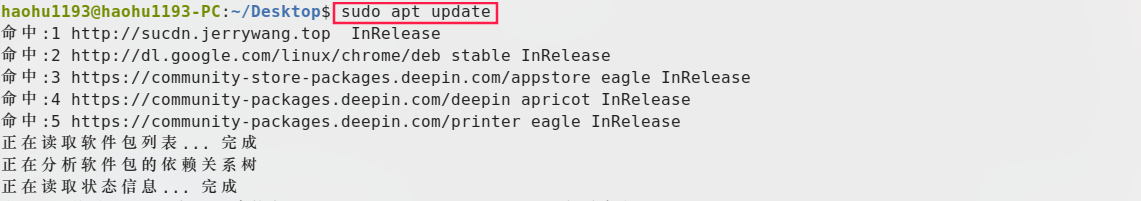

随便逛逛
2020-09-28 04:28
sudo apt update
结果发出来看看...我是1002全新安装的...

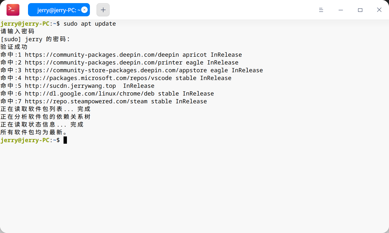

JerryABCD
2020-09-28 05:08
JerryABCD
2020-09-28 05:12
