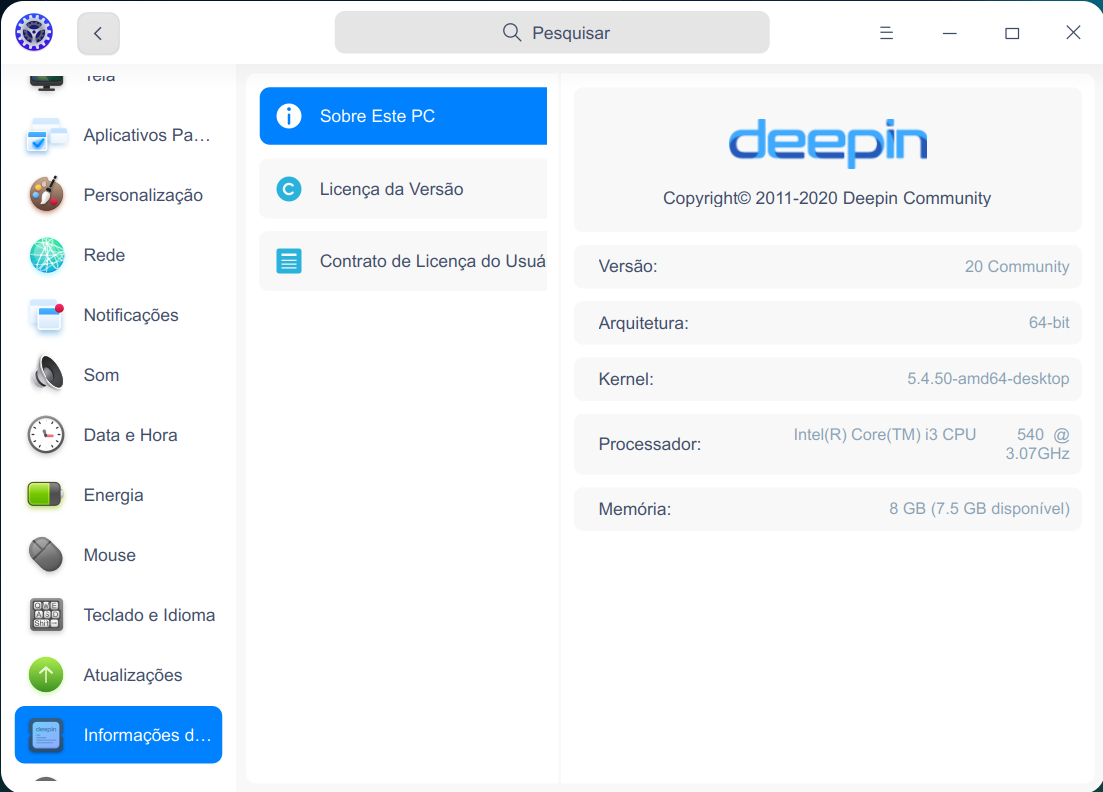

Hello Deepin Team
In the morning there was an update and there were several errors.
The upgrade downgraded some applications and upgraded others.
I solved a lot on the nail, but in the end it was functional.
There was no kernel option 5.4 or 5.7 during installation.
Here are some errors in this update:
sudo journalctl -p 3 -xb
-- Logs begin at Tue 2020-08-25 10:41:52 -03, end at Tue 2020-08-25 20:36:34 -03. --
ago 25 20:35:55 edson-pc6540br systemd-modules-load[316]: Failed to find module 'vfs_monitor'
ago 25 20:35:55 edson-pc6540br systemd[1]: Failed to start Load Kernel Modules.
-- Subject: A unidade systemd-modules-load.service falhou
-- Defined-By: systemd
-- Support: https://www.debian.org/support
-- A unidade systemd-modules-load.service falhou.
-- O resultado é failed.
ago 25 20:36:00 edson-pc6540br systemd-modules-load[543]: Failed to find module 'vfs_monitor'
ago 25 20:36:00 edson-pc6540br systemd[1]: Failed to start Load Kernel Modules.
ago 25 20:36:01 edson-pc6540br kernel: Error: Driver 'pcspkr' is already registered, aborting...
ago 25 20:36:02 edson-pc6540br systemd-modules-load[1228]: Failed to find module 'vfs_monitor'
ago 25 20:36:02 edson-pc6540br systemd[1]: Failed to start Load Kernel Modules.
journalctl -b -0 | grep failed
Hint: You are currently not seeing messages from other users and the system.
      Users in groups 'adm', 'systemd-journal' can see all messages.
      Pass -q to turn off this notice.
ago 25 17:37:30 edson-pc6540br dbus-daemon[5939]: [session uid=1000 pid=5939] Activated service 'com.deepin.dde.daemon.Launcher' failed: Process com.deepin.dde.daemon.Launcher exited with status 1
ago 25 17:37:31 edson-pc6540br dbus-daemon[5939]: [session uid=1000 pid=5939] Activated service 'com.deepin.dde.daemon.Launcher' failed: Process com.deepin.dde.daemon.Launcher exited with status 1
ago 25 17:37:32 edson-pc6540br dbus-daemon[5939]: [session uid=1000 pid=5939] Activated service 'com.deepin.dde.daemon.Launcher' failed: Process com.deepin.dde.daemon.Launcher exited with status 1
ago 25 17:37:33 edson-pc6540br dbus-daemon[5939]: [session uid=1000 pid=5939] Activated service 'com.deepin.dde.daemon.Launcher' failed: Process com.deepin.dde.daemon.Launcher exited with status 1
ago 25 17:37:34 edson-pc6540br dbus-daemon[5939]: [session uid=1000 pid=5939] Activated service 'com.deepin.dde.daemon.Launcher' failed: Process com.deepin.dde.daemon.Launcher exited with status 1
ago 25 17:37:35 edson-pc6540br dbus-daemon[5939]: [session uid=1000 pid=5939] Activated service 'com.deepin.dde.daemon.Launcher' failed: Process com.deepin.dde.daemon.Launcher exited with status 1
ago 25 17:37:36 edson-pc6540br dbus-daemon[5939]: [session uid=1000 pid=5939] Activated service 'com.deepin.dde.daemon.Launcher' failed: Process com.deepin.dde.daemon.Launcher exited with status 1
ago 25 17:37:37 edson-pc6540br dbus-daemon[5939]: [session uid=1000 pid=5939] Activated service 'com.deepin.dde.daemon.Launcher' failed: Process com.deepin.dde.daemon.Launcher exited with status 1
ago 25 17:37:38 edson-pc6540br dbus-daemon[5939]: [session uid=1000 pid=5939] Activated service 'com.deepin.dde.daemon.Launcher' failed: Process com.deepin.dde.daemon.Launcher exited with status 1
ago 25 17:37:39 edson-pc6540br dbus-daemon[5939]: [session uid=1000 pid=5939] Activated service 'com.deepin.dde.daemon.Launcher' failed: Process com.deepin.dde.daemon.Launcher exited with status 1
ago 25 17:37:40 edson-pc6540br dbus-daemon[5939]: [session uid=1000 pid=5939] Activated service 'com.deepin.dde.daemon.Launcher' failed: Process com.deepin.dde.daemon.Launcher exited with status 1
ago 25 17:37:41 edson-pc6540br dbus-daemon[5939]: [session uid=1000 pid=5939] Activated service 'com.deepin.dde.daemon.Launcher' failed: Process com.deepin.dde.daemon.Launcher exited with status 1
ago 25 17:37:42 edson-pc6540br dbus-daemon[5939]: [session uid=1000 pid=5939] Activated service 'com.deepin.dde.daemon.Launcher' failed: Process com.deepin.dde.daemon.Launcher exited with status 1
ago 25 17:37:43 edson-pc6540br dbus-daemon[5939]: [session uid=1000 pid=5939] Activated service 'com.deepin.dde.daemon.Launcher' failed: Process com.deepin.dde.daemon.Launcher exited with status 1
ago 25 17:37:44 edson-pc6540br dbus-daemon[5939]: [session uid=1000 pid=5939] Activated service 'com.deepin.dde.daemon.Launcher' failed: Process com.deepin.dde.daemon.Launcher exited with status 1
ago 25 17:37:45 edson-pc6540br dbus-daemon[5939]: [session uid=1000 pid=5939] Activated service 'com.deepin.dde.daemon.Launcher' failed: Process com.deepin.dde.daemon.Launcher exited with status 1
ago 25 17:37:46 edson-pc6540br dbus-daemon[5939]: [session uid=1000 pid=5939] Activated service 'com.deepin.dde.daemon.Launcher' failed: Process com.deepin.dde.daemon.Launcher exited with status 1
ago 25 17:37:47 edson-pc6540br dbus-daemon[5939]: [session uid=1000 pid=5939] Activated service 'com.deepin.dde.daemon.Launcher' failed: Process com.deepin.dde.daemon.Launcher exited with status 1
ago 25 17:37:48 edson-pc6540br dbus-daemon[5939]: [session uid=1000 pid=5939] Activated service 'com.deepin.dde.daemon.Launcher' failed: Process com.deepin.dde.daemon.Launcher exited with status 1
ago 25 17:37:49 edson-pc6540br dbus-daemon[5939]: [session uid=1000 pid=5939] Activated service 'com.deepin.dde.daemon.Launcher' failed: Process com.deepin.dde.daemon.Launcher exited with status 1
ago 25 17:37:50 edson-pc6540br dde-session-dae[7403]: g_value_set_boxed: assertion 'G_VALUE_HOLDS_BOXED (value)' failed
ago 25 17:37:51 edson-pc6540br daemon/bluetooth[7088]: agent.go:245: failed to register agent: Failed to activate service 'org.bluez': timed out (service_start_timeout=25000ms)
ago 25 17:37:51 edson-pc6540br pulseaudio[6922]: E: [pulseaudio] bluez5-util.c: GetManagedObjects() failed: org.freedesktop.DBus.Error.TimedOut: Failed to activate service 'org.bluez': timed out (service_start_timeout=25000ms)
ago 25 17:37:53 edson-pc6540br startdde[5900]: startmanager.go:260: launch failed: reserved character '\'' is not be quoted
ago 25 17:45:58 edson-pc6540br cursor-helper[15635]: g_value_set_boxed: assertion 'G_VALUE_HOLDS_BOXED (value)' failed
ago 25 17:46:16 edson-pc6540br cursor-helper[15671]: g_value_set_boxed: assertion 'G_VALUE_HOLDS_BOXED (value)' failed
ago 25 17:47:03 edson-pc6540br xdg-desktop-por[15885]: g_value_set_boxed: assertion 'G_VALUE_HOLDS_BOXED (value)' failed
ago 25 18:02:09 edson-pc6540br clipboard[7088]: manager.go:311: failed to convert clipboard targets
dmesg | grep -i error
[    1.324573] RAS: Correctable Errors collector initialized.
[   16.699825] Error: Driver 'pcspkr' is already registered, aborting...
