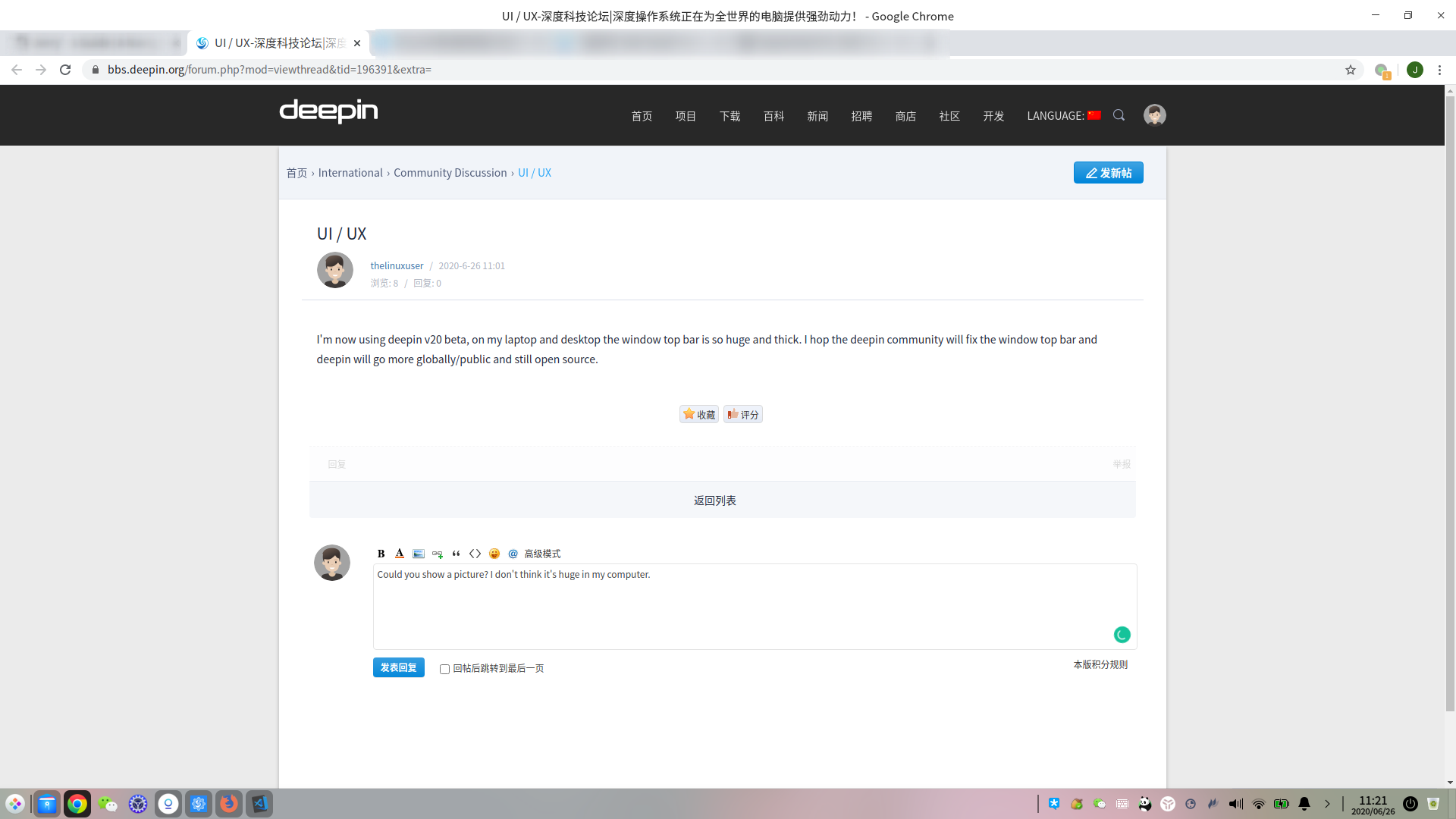

I'm now using deepin v20 beta, on my laptop and desktop the window top bar is so huge and thick. I hop the deepin community will fix the window top bar and deepin will go more globally/public and still open source.

Could you show a picture? I don't think it's huge in my computer.

I compare with windows 10 window top bar, deepin window top bar is so huge.
my  display pixel is 1360x768.

I hightlight with black

For the non-system apps,you can set the window's title bar follow this waythere is no way to set the hight of title bar  for system apps)
  1. mkdir -p ~/.local/share/deepin/themes/deepin/light
  2. mkdir -p ~/.local/share/deepin/themes/deepin/dark
  3. touch ~/.local/share/deepin/themes/deepin/light/titlebar.ini
  4. touch ~/.local/share/deepin/themes/deepin/dark/titlebar.ini
  5. cd ~/.local/share/deepin/themes/deepin/light
  6. deepin-editor titlebar.ini
  7. cd ~/.local/share/deepin/themes/deepin/dark
  8. deepin-editor titlebar.ini
Copy the Code
the  content to be added to titlebar.ini:
  1. [Active]
  2. height=24
  3. [Inactive]
  4. height=24
Copy the Code
