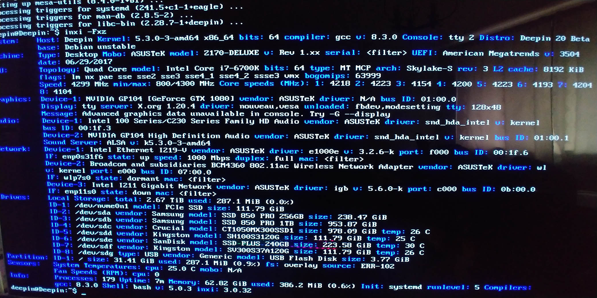

Hi,
The default installer kernel boot parameters result in video signal loss short after booting - I never make it to the GUI.

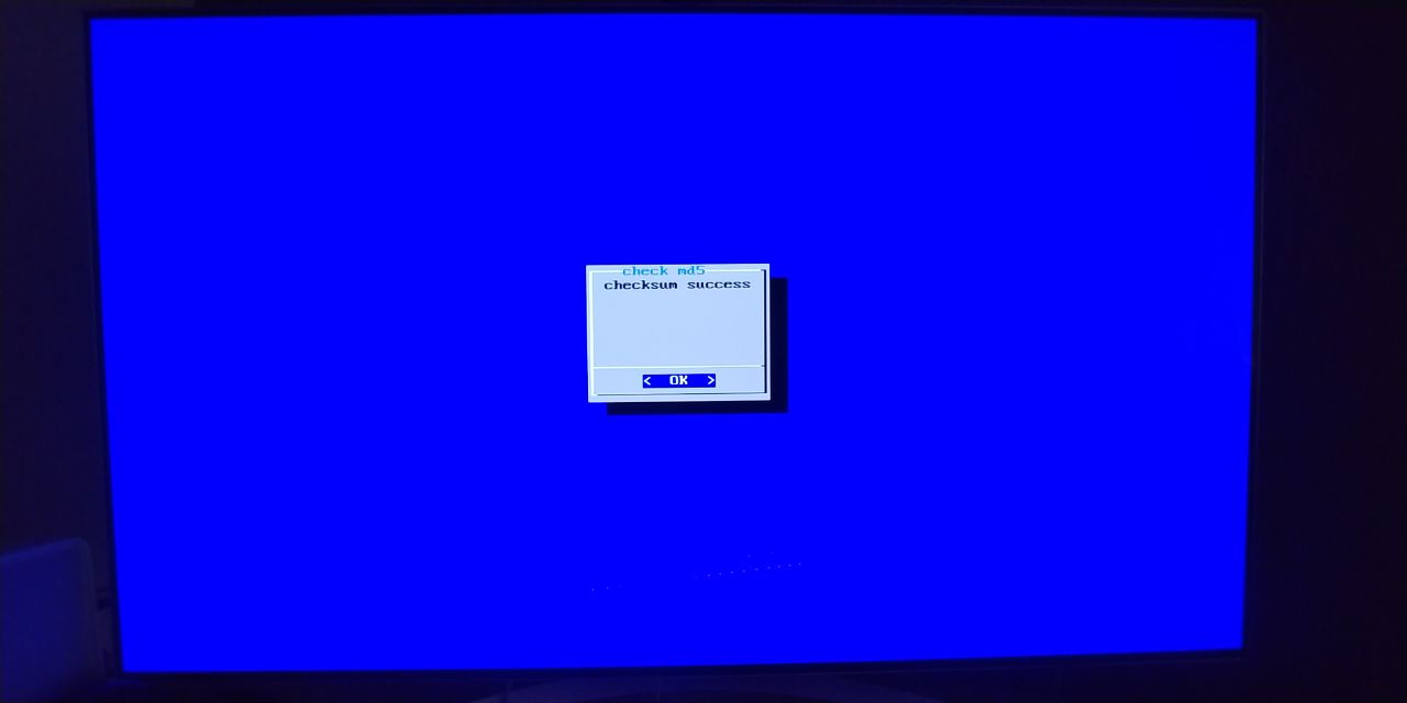

When launching MD5 checker with additional parameters like (nomodeset or nouveau.modeset=0) it works, and does not loose video signal.
Unfortunately, the same trick (with nomodeset or nouveau.modeset=0) does not help with launching the installer - it gets stuck and never makes it to the GUI.
What parameters should I add (or remove) to launch the installer on the following machine?

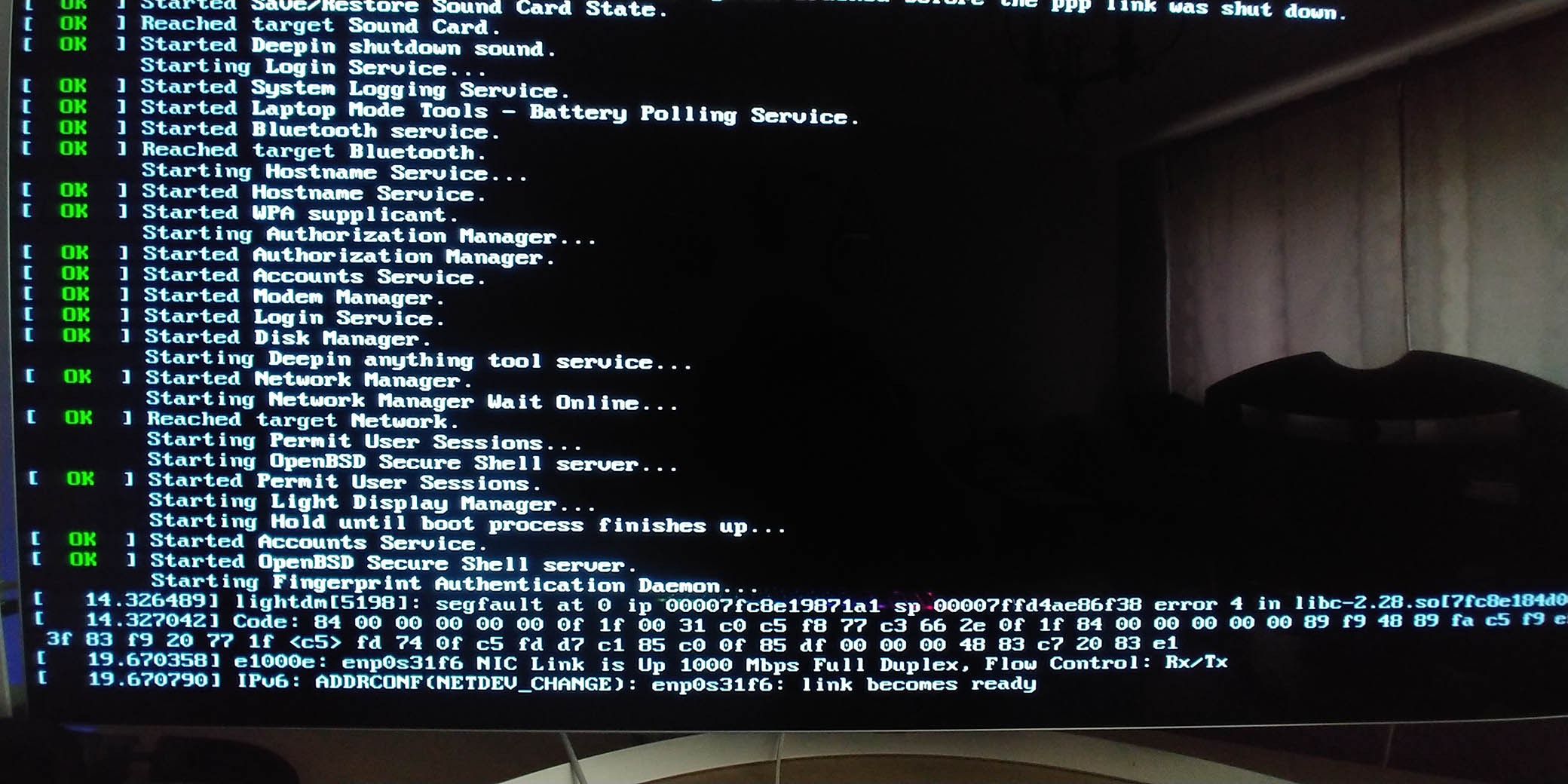

do you have access to tty ? seems its lightdm segmentation fault
Comments
danygee
2020-04-19 01:35
Yeah, I can access other TTY's. Any ideas what it might help with?

Iso was checked and OK.
USB was checked on other machine and OK.
Any other ideas?
xenups
2020-04-19 07:23
https://bbs.deepin.org/post/191744
in /etc/lightdm/lightdm.conf
Find the (uncommented) line greeter-session= and set it to
greeter-session=lightdm-deepin-greeter
and try to systemctl start lightdm.service
danygee
2020-04-19 23:38
greeter-se ...
This also didn't help - boot still hangs.
