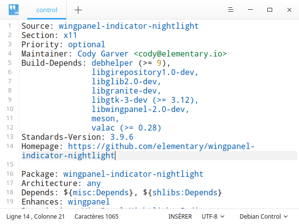

In fact the .zip didn't give a .deb, may be it is why dpkg don't work. And there's a missing dependency : libwingpanel-2.0-dev.
When I run "install" I have this in terminal
  1. /home/leo/Downloads/wingpanel-indicator-nightlight-pantheon-debian-daily/debian/install: 1: /home/leo/Downloads/wingpanel-indicator-nightlight-pantheon-debian-daily/debian/install: usr/lib: not found
  2. /home/leo/Downloads/wingpanel-indicator-nightlight-pantheon-debian-daily/debian/install: 2: /home/leo/Downloads/wingpanel-indicator-nightlight-pantheon-debian-daily/debian/install: usr/share: not found

2020-04-08 04:15
I don't think it will work on deepin since it is made for the wingpanel on elementary.
Maybe you should try other alternatives like redshift ?
