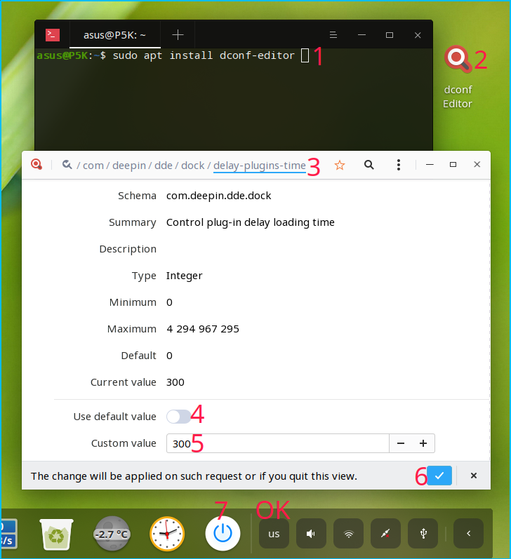

I found a solution of this problem.
Install dconf-editor. Run it and go to the item /com/deepin/dde/dock/delay-plugins-time.
Disable Use default value and set the Custom value to 300 then apply and logout. If it does not help then set 400 or 500.

This solution allows loading dock widgets with a delay (in milliseconds). Try experimenting with this value.The keyboard switch widget started after a system reboot.

v14dober
2020-02-10 17:44
Set between 500 and 1000 and don't forget to end the session
that was perfect
I set it to a thousand
fixed
Thank you very much
Now shows the language selection icon
