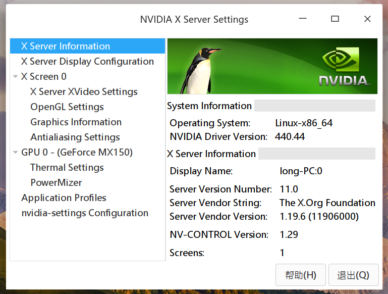

longzhou
2019-12-14 01:31
#42
已经切换成功了,用的是这个帖子里面的方法(好的配置文件需要新建)。谢谢各位大大……
https://bbs.deepin.org/post/178542##=1NVIDIA X Server Settings也可以正常打开了。
截图如下:
  1. long@long-PC:~$ nvidia-smi
  2. Fri Dec 13 17:05:45 2019
  3. +-----------------------------------------------------------------------------+
  4. | NVIDIA-SMI 440.44       Driver Version: 440.44       CUDA Version: 10.2     |
  5. |-------------------------------+----------------------+----------------------+
  6. | GPU  Name        Persistence-M| Bus-Id        Disp.A | Volatile Uncorr. ECC |
  7. | Fan  Temp  Perf  Pwr:Usage/Cap|         Memory-Usage | GPU-Util  Compute M. |
  8. |===============================+======================+======================|
  9. |   0  GeForce MX150       Off  | 00000000:01:00.0 Off |                  N/A |
  10. | N/A   54C    P0    N/A /  N/A |    230MiB /  2002MiB |      3%      Default |
  11. +-------------------------------+----------------------+----------------------+
  12.
  13. +-----------------------------------------------------------------------------+
  14. | Processes:                                                       GPU Memory |
  15. |  GPU       PID   Type   Process name                             Usage      |
  16. |=============================================================================|
  17. |    0      3920      G   /usr/lib/xorg/Xorg                           151MiB |
  18. |    0      7565      G   kwin_x11                                      19MiB |
  19. |    0      8089      G   ...quest-channel-token=2982751489414219231    57MiB |
  20. +-----------------------------------------------------------------------------+
Copy the Code

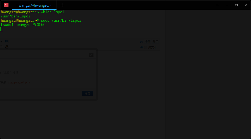

hwangzhic
2020-01-09 17:49
#54
file:///home/hwangzc/Documents/%E6%B7%B1%E5%BA%A6%E6%88%AA%E5%9B%BE_%E9%80%89%E6%8B%A9%E5%8C%BA%E5%9F%9F_20200109094757.png
deepinuser17
2020-01-09 19:07
#55
运行一下这些命令:
which lspci
/usr/bin/lspci
sudo /usr/bin/lspci
hwangzhic
2020-01-09 20:47
#56
https://bbs.deepin.org/post/185547
运行一下这些命令:
which lspci
还是卡主,不动了
deepinuser17
2020-01-09 21:14
#57
还是卡主,不动了
这个问题我还没有遇到过。可能是开源驱动nouveau造成的问题。
