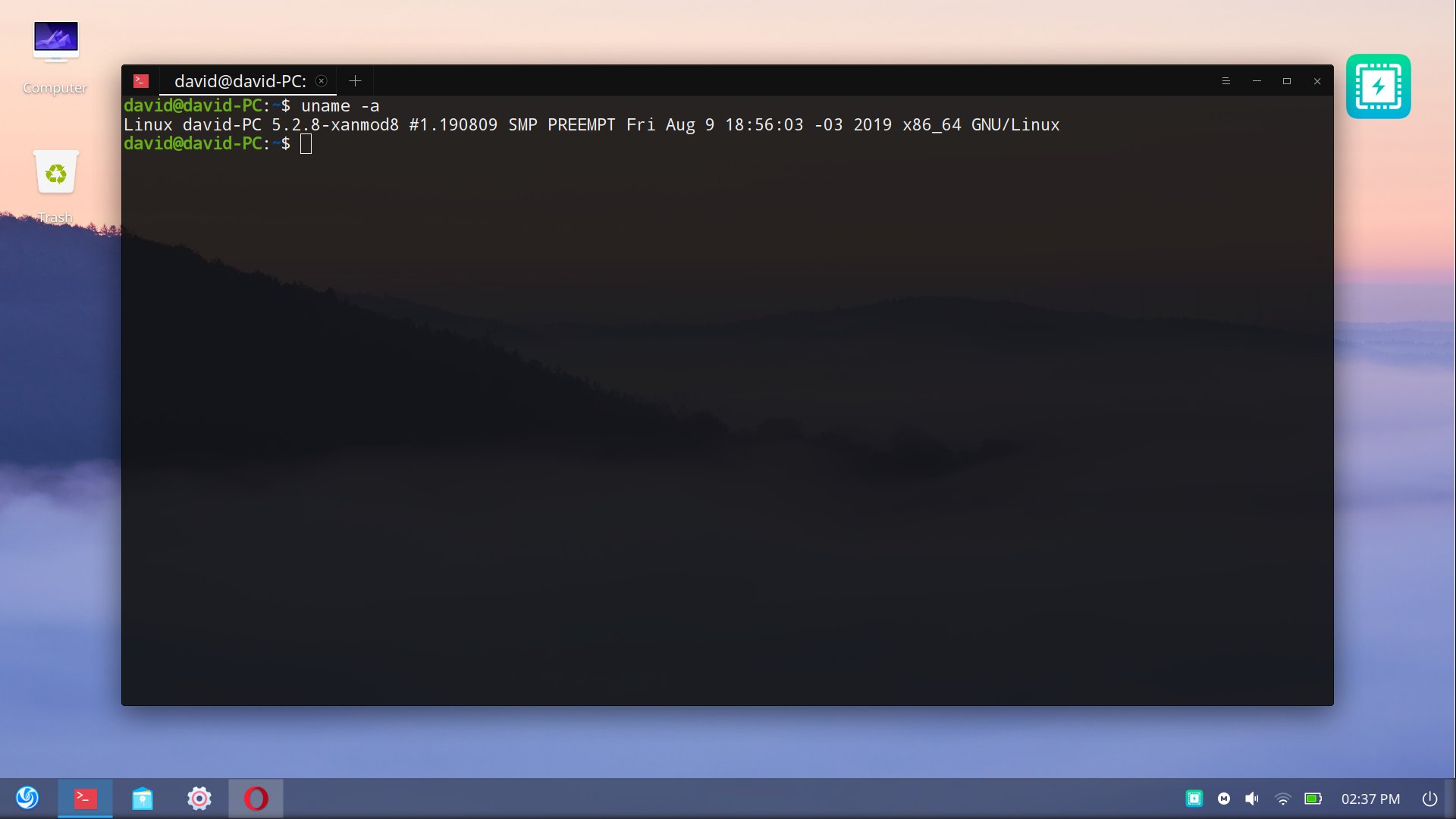

Kernel 5.2.13 available ! You can update your system
Update 08-26
Kernel 5.2.10 available ! You can update your system
Update 08-21
In some case, you need before installing this new kernel, remove the driver for your nVidia or AMD GPU and use the base graphic driver not the closed driver.
after installing the new kernel, you can install again the graphic driver.
You can install the Kernel 5.2.8.
For this, add my repository with this : https://lvtommy.com/depot/
您可以安装内核5.2.8
为此,添加我的存储库:https://lvtommy.com/zh/储备库/
After installing the repository, please update the Apt cache :
  • Open Deepin terminal
  • Run the following command :sudo apt update
To install the new kernel, after adding my kernel repo, install this package : sudo apt install lvtommy-linux-kernel
安装后,请更新Apt缓存 :
  • 打开Deepin终端
  • 运行以下命令 :sudo apt update
要安装新内核,在添加我的内核仓库后,安装此软件包:sudo apt install lvtommy-linux-kernel
