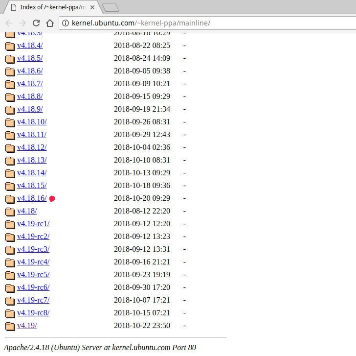

You have two options: Compiling it yourself and installing it, or just installing it with a pre-compiled kernel.
I recommend the latter to save time and storage, proceed to download the kernel you may want from http://kernel.ubuntu.com/~kernel-ppa/mainline/

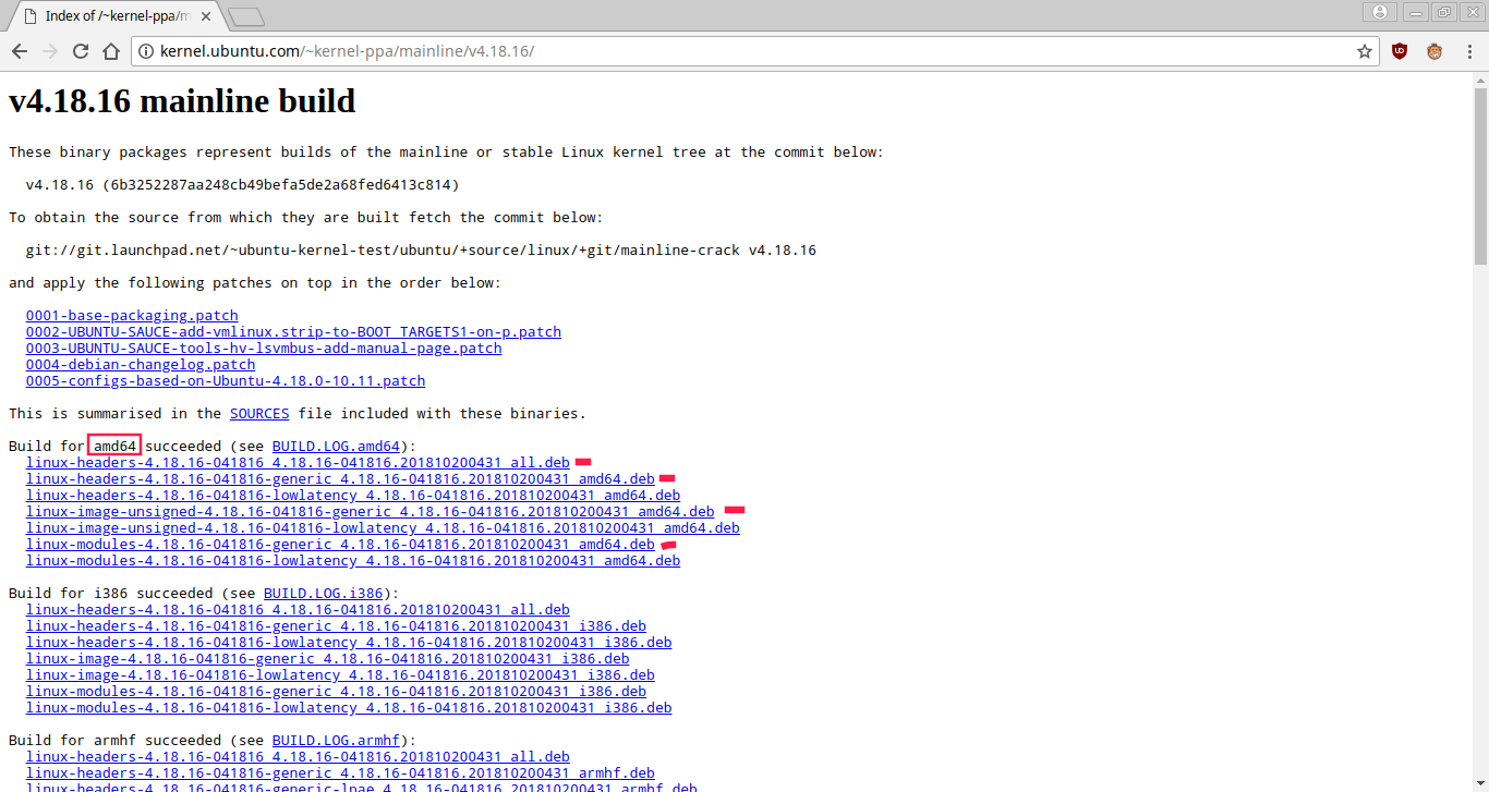

Let's say you want to install the Kernel 4.18.16, but this applies for any kernel version you want, so you head to the folder that corresponds to the version you want, and download the files for the architecture you need, most of the times is amd64, and this is your case too, make sure to download the following 4 files:
Linux-headers [version number] [then the version number again].deb
Linux-headers [version number] - generic [then the version number again].deb
Linux-image-unsigned [version number] - generic [then the version number again].deb
Linux-modules [version number] - generic [then the version number again].deb
Once you have those files you're ready to install them, you could use the graphic method or the console method, they both work.
Install them in the following order (and don't be afraid of messing this up, even if you opened them in different order the package won't install because of missing dependencies)
And that's it, you only have to reboot now.
After rebooting open the terminal and type
uname -a
The output will be your current kernel and it should be the one you just installed.
