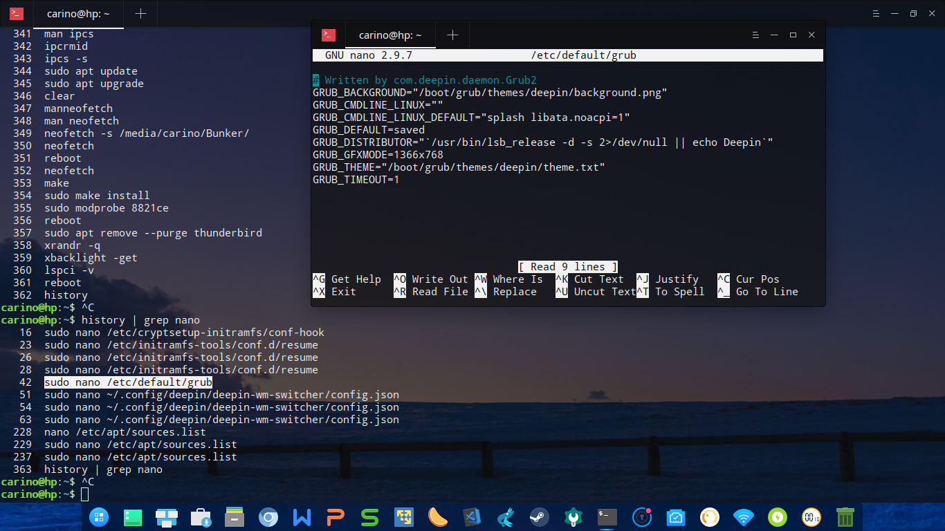

4. Edit /etc/default/grub
GRUB_CMDLINE_LINUX_DEFAULT="splash quiet" change it into GRUB_CMDLINE_LINUX_DEFAULT="libata.noacpi=1"

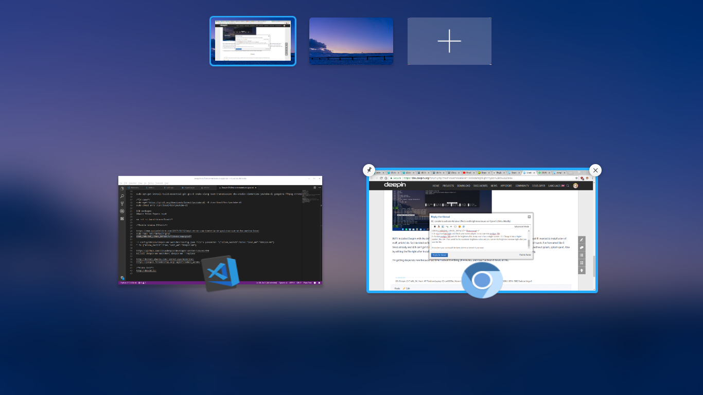

>No Windows Effects

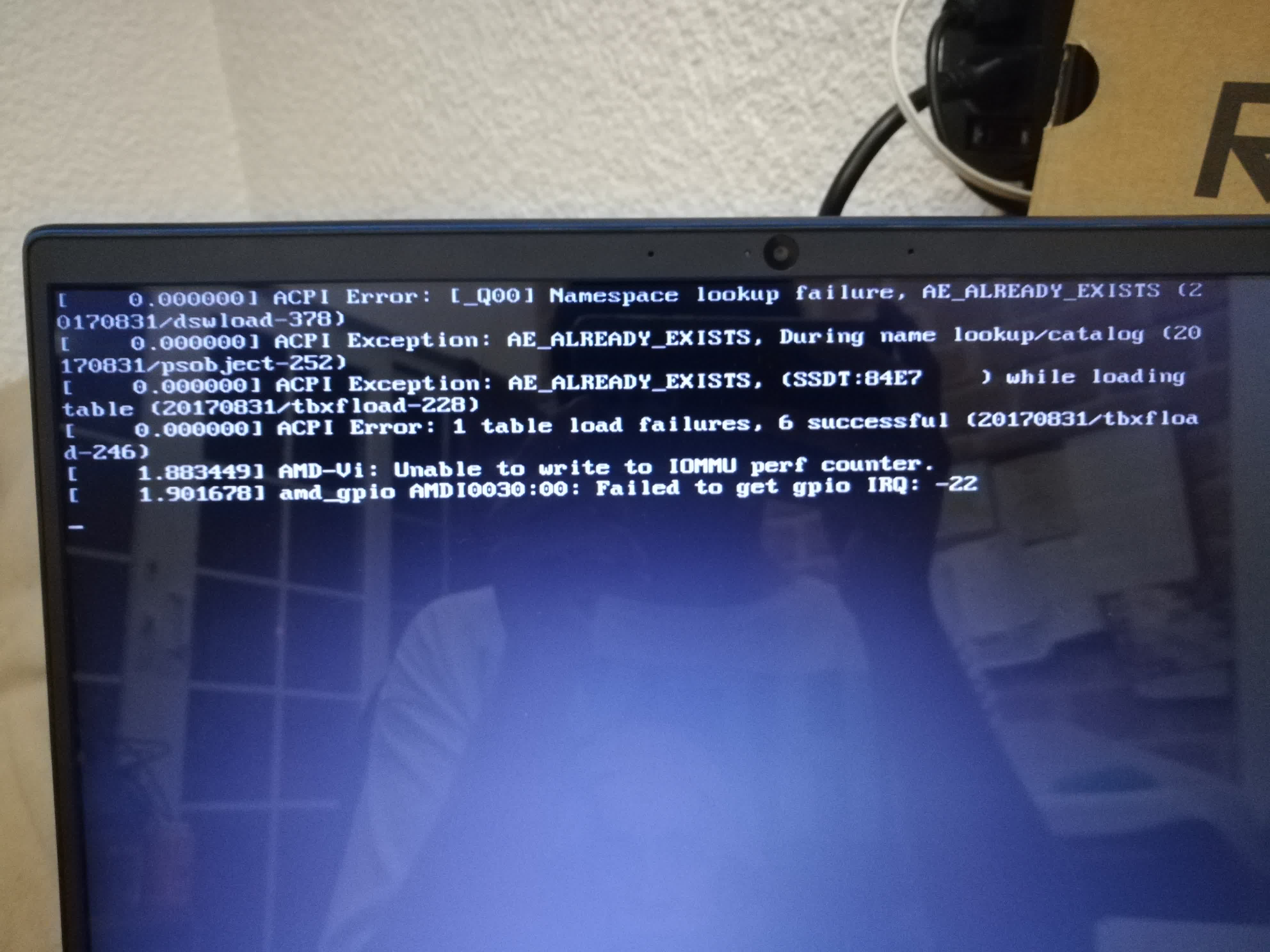

BUT, there are some erros during the boot, which are pic related.

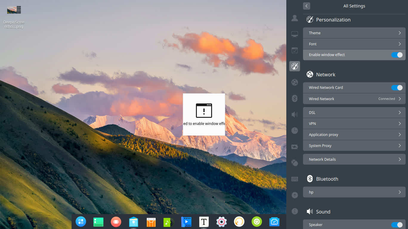

>Edit the ~/.config/deepin/deepin-wm-switcher/config.json file's parameter "{"allow_switch":false,"last_wm":"deepin-wm"}
" to {"allow_switch":true,"last_wm":"deepin-wm"}

>No Windows Effects

So, I did google about the booting errors and found out I had to edit the grub and add the following parameter.
What I found out in the file was GRUB_CMDLINE_LINUX_DEFAULT="splash quiet" so I did change it to GRUB_CMDLINE_LINUX_DEFAULT="splash libata.noacpi=1"
What happened was that after the reboot, brightness was at normal levels and Windows Effects were back, I had no issues at all and everything was functional.
