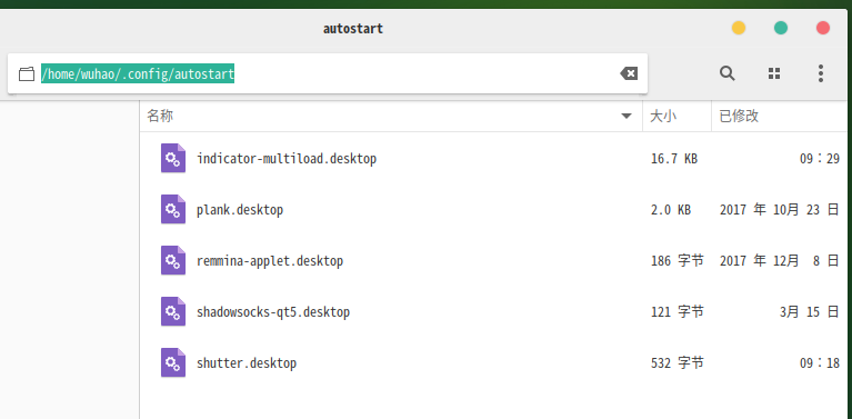

~/.config/autostart/

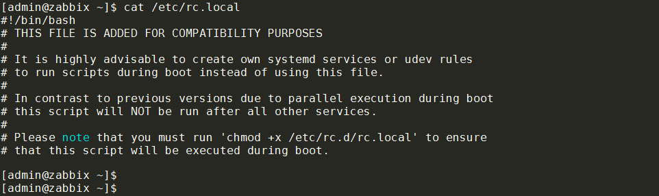

You can also put it in the /etc/rc.d/rc.local file. if without this file, create it.
1. $ sudo vi /etc/rc.d/rc.local
2. put command into bottom
3. $ sudo chmod +x /etc/rc.d/rc.local
132******85
2018-03-22 17:39
https://bbs.deepin.org/post/154428
i tried, but not working too!
Like this, my test is effective.
But my system environment is ubuntu+dde
