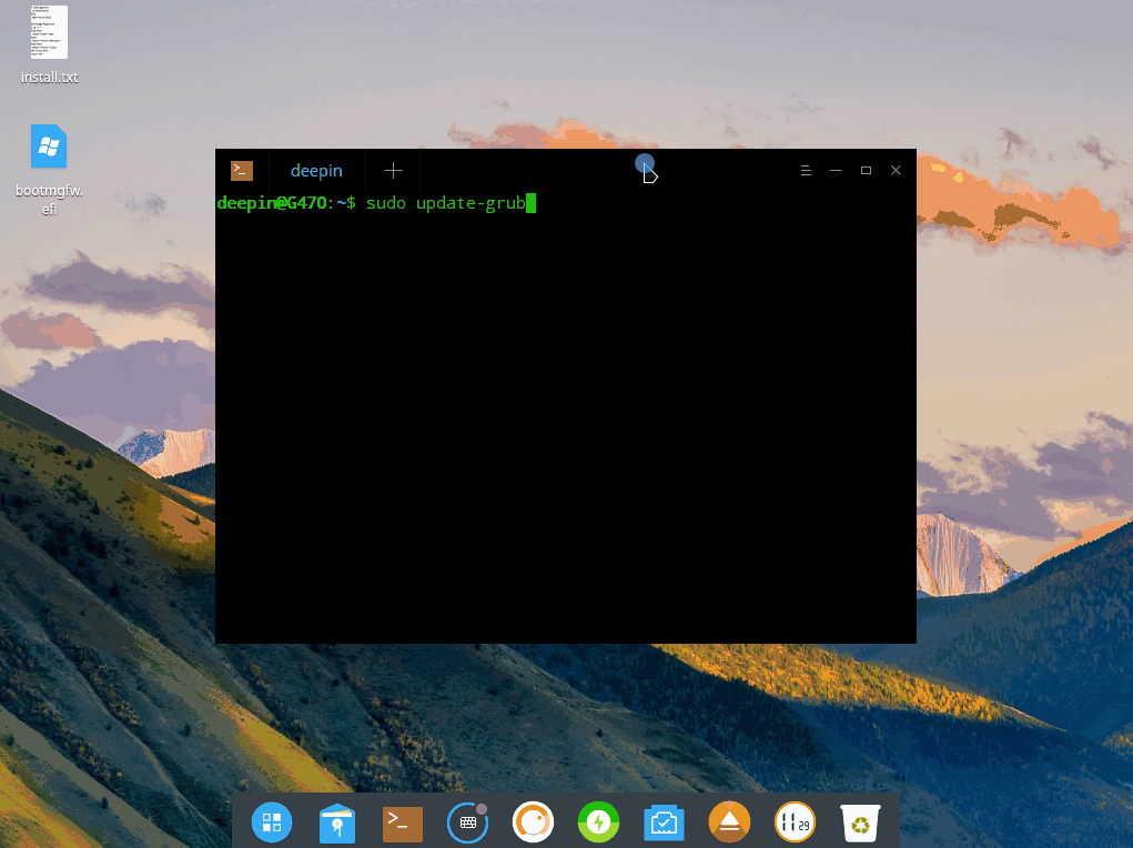

2018-01-28 06:23

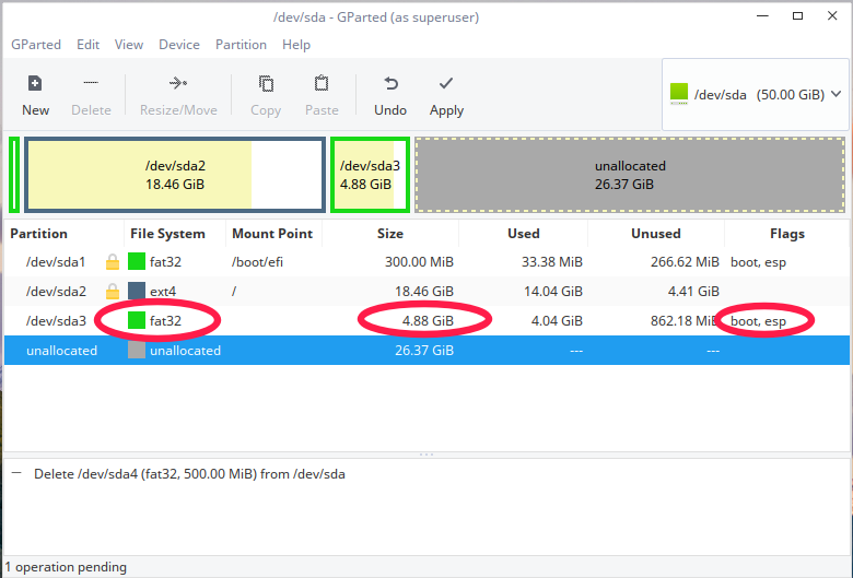

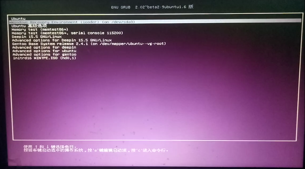

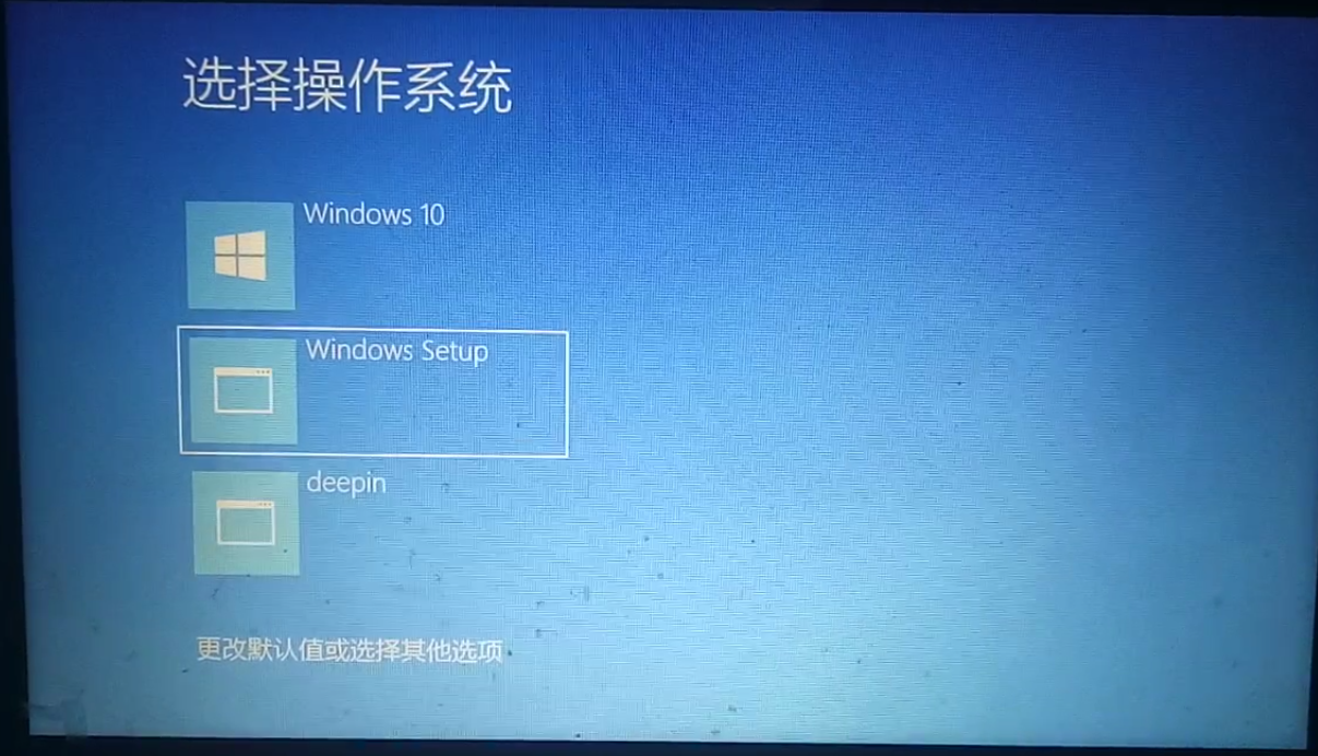

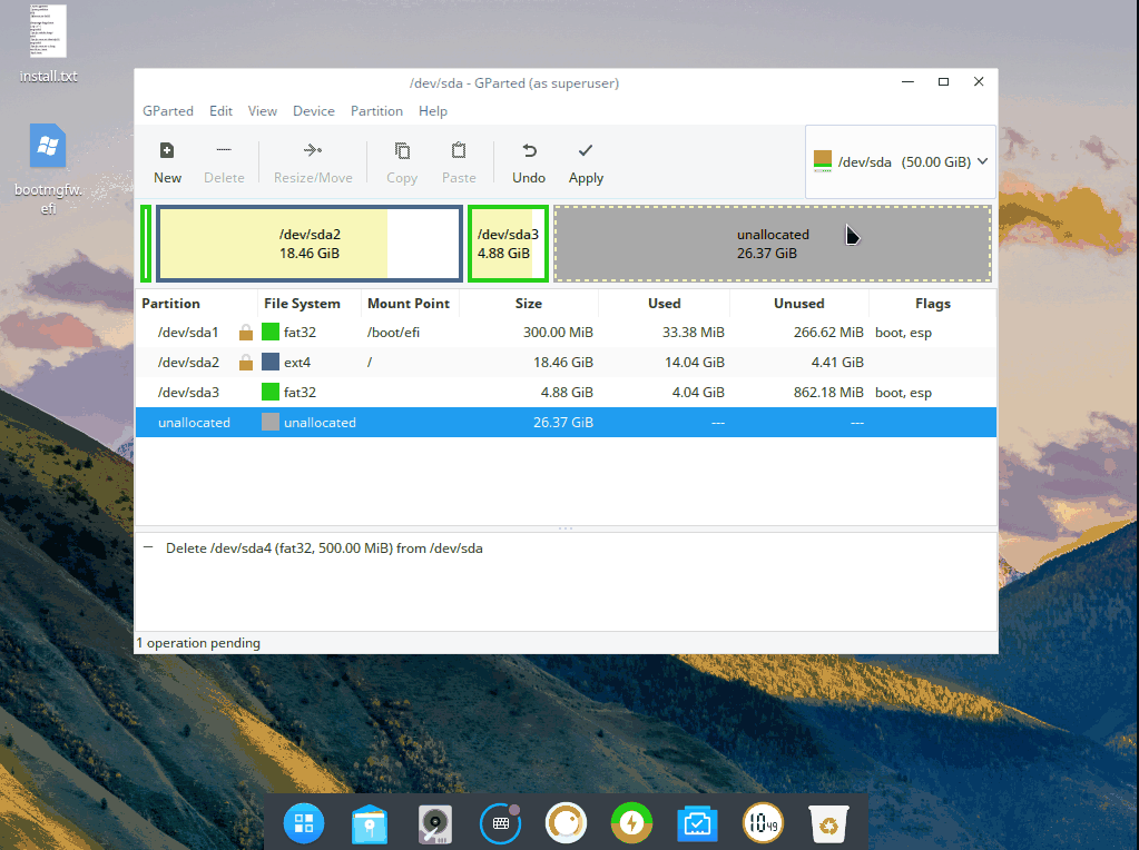

#30
uefi+gpt
1.sudo gparted
1)new partition 5Gb
2)format to fat32
3)manage flags boot
2.cp -a * /tmp/sda3
1)sudo mkdir /tmp/sda3
2)sudo mount /dev/sda3 /tmp/sda3
3)sudo mount -o loop win10.iso /mnt
4)cd /mnt
5)sudo cp -a * /tmp/sda3
3.cp bootmgfw.efi to /tmp/sda3/efi/microsoft/boot
1)open /mnt/sources/boot.win with archive manager
2)extract /mnt/sources/boot.win/1/windows/boot/efi/bootmgfw.efi to /tmp/sda3/efi/microsoft/boot
4.sudo update-grub
5.reboot system then choice win10 install
