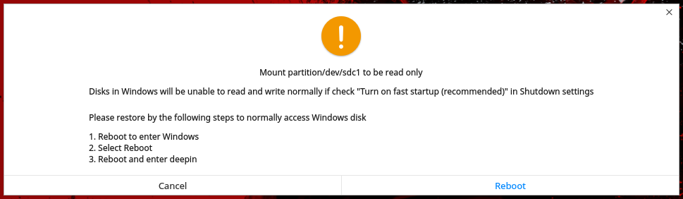

I keep getting this dialog at start-up.
I did as advised but I still get it.
ARWhooo
2018-01-05 05:22
Well, the problem you've facing right now is because of the disk lock down caused by Windows. Maybe you should try Power Off instead of Reboot, and google how to disable Windows's 'Fast Boot' technique.
dxpe
2018-01-05 07:40
Edited by dxpe at 2018-1-4 23:48
https://bbs.deepin.org/post/151159
Well, the problem you've facing right now is because of the disk lock down caused by Windows. Maybe  ...
I did disable it, and still got it. I'll try to shut down instead of reboot to see what happens
EDIT:

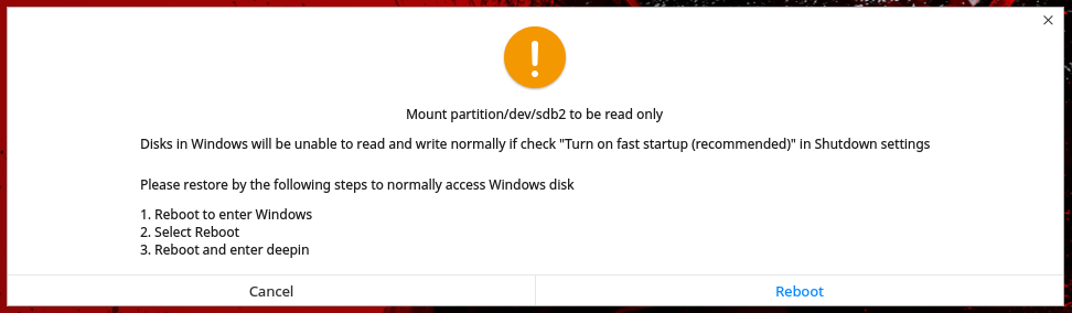

After the shut down, I get the same dialog but for my other hard drive (which doesn't have Windows installed on it).

EDIT: After the dialog about /dev/sdc1, I get the same for dev/sdb2 once again.

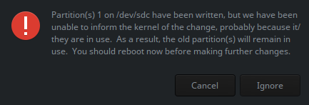

EDIT: This is what happens when I enter gparted.
duanyao
2018-01-06 00:29
So why did you fsck sda1 when you have problem with sdc1 and sdb2?
