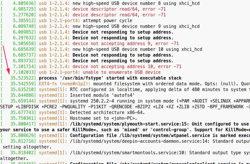

ssd 500G固态,去年还是很快,现在是越来越慢了。
❯ systemd-analyze
Startup finished in 6.726s (firmware) + 6.366s (loader) + 35.812s (kernel) + 10.119s (userspace) = 59.025s
graphical.target reached after 10.112s in userspace
❯ uname -a
Linux john-PC 5.15.77-amd64-desktop #2 SMP Thu Jun 15 16:06:18 CST 2023 x86_64 GNU/Linux
HoneyGIFT
2024-03-11 01:17
#40
❯ systemd-analyze
Startup finished in 7.429s (firmware) + 2.395s (loader) + 35.627s (kernel) + 9.841s (userspace) = 55.293s
graphical.target reached after 9.833s in userspace
❯ dmesg > dmesg.txt
