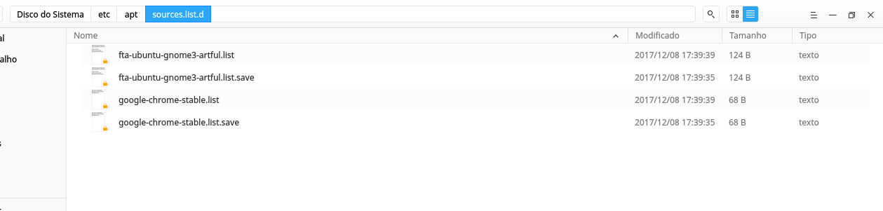

When you access the /etc/apt/sources.list.d/ directory, the following files appear:
aida
2017-12-21 02:53
please provide your sources list here. And you have add a lot in source list?

Hello Aida. I'm new to Linux. Would that be it?

In the previous post I put an image of the directory sources.list.d.

From the first thread, we see that you have added some third-party source while the source list is OK.
Please clear the source in /etc/apt/sources.list.d$
josemarcos
2017-12-22 03:21
https://bbs.deepin.org/post/150414
From the first thread, we see that you have added some third-party source while the source list is ...
Perfect Aida. Worked. Thank you! 谢谢
