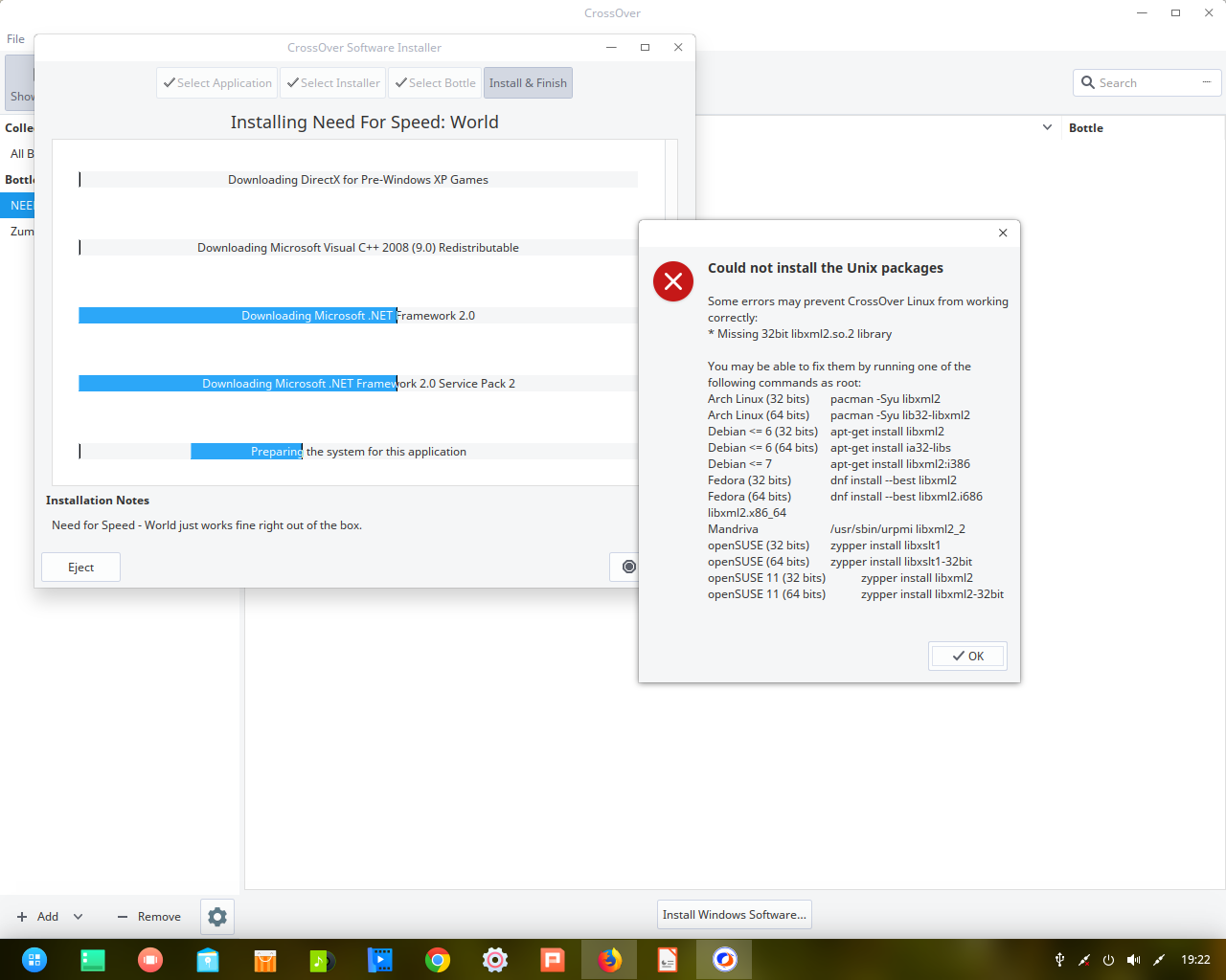

[Solved] how to fix crossover deepin 15.5

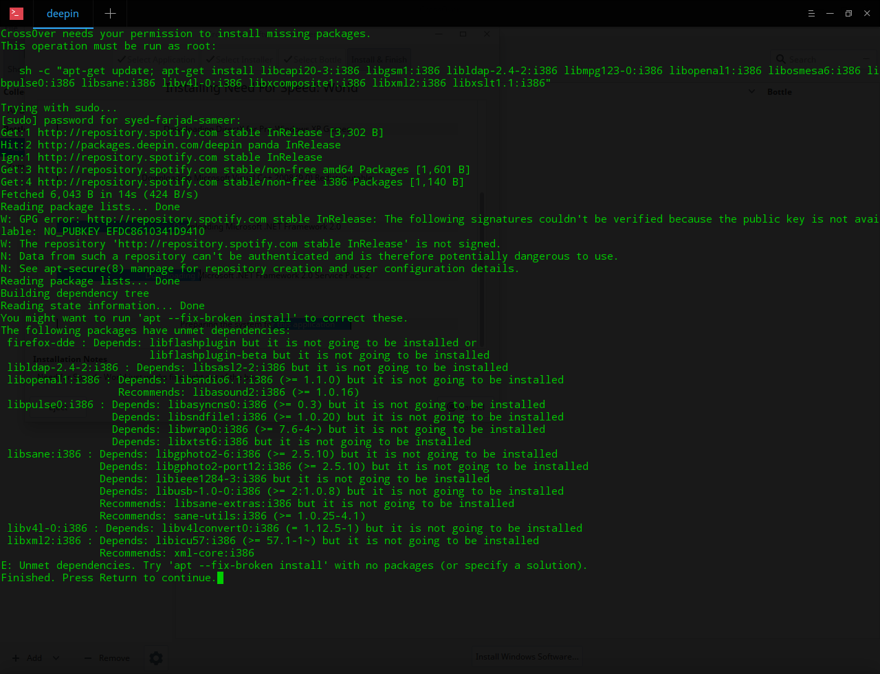

Run the following command:
sudo apt-get --fix-broken install
Now try again what you did before.
Still not working , i just check list of deepin servers by country , my country is pakistan and in list there is no pakistani deepin server . i think i am unble to download files because my ip is from Pakistan. am i right ?
nipos
2017-12-14 06:07
No,you're wrong.
Everyone can use the download servers from every country.
The advantage of servers from your own country is that they are faster.
If you use the servers from a country near to you,that works well,too.
There is a problem with the dependencies of your installed programs.
That looks really bad but I don't know how to fix it.

wtz
2017-12-15 07:41
https://bbs.deepin.org/post/150023
thank you for  helping and giving me useful information i am new to linux ,  i think i found the r ...
The post that you mentioned has nothing to do with the problem you met.
Please re-run the command in terminal
  1. sudo apt-get --fix-broken install
Copy the Code
and post the output in text rather in a screenshot. It's recommended to save all output in a plain text file, then upload it as an attachment.

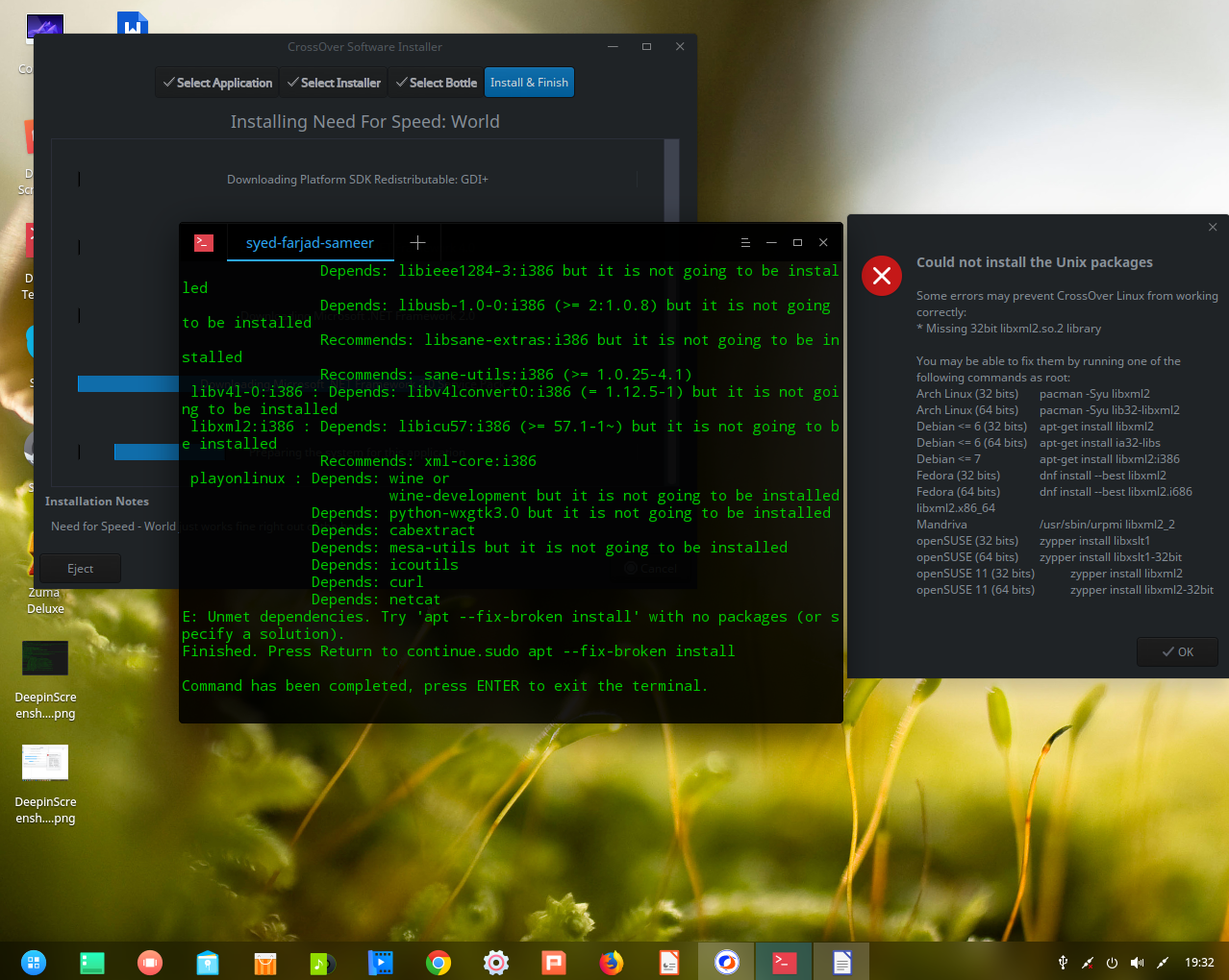

sfsking
2017-12-16 06:19
Please re-run the command ...
problem solved by using
sudo apt-get -f install
found this cammand line in the  below link
https://github.com/brave/browser-laptop/blob/master/docs/linuxInstall.md
