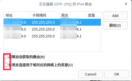

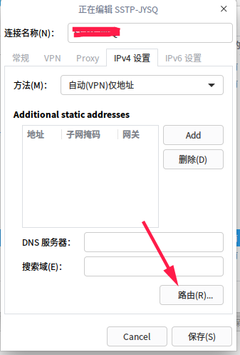

I would like to ask how to do a separate VPN connection between network gets from VPN and the rest of the internet
In other Network panel this called " Use this connection only for resources on its network "
I mean, if I got a route from the VPN to 10.0.0.1/16 and I want to connect to 10.0.100.24, then it leads me through the VPN tunnel.
And if I want to go to google.com then leads me bypassing the VPN tunnel by normal connection.
Now I have so that all traffic goes through the VPN tunnel.
Is this somewhere in control panel to click for set up this? because I can't find it.

The option has been added, but not sync, please wait for update.

  1. sudo apt-get install network-manager-gnome
Copy the Code
for first time(if you don't reboot)
  1. nm-connection-editor
  2. nm-applet
Copy the Code
the next time click the nm-applet in try area

OK, i find other solution without install anything else and it's work!
since deepin uses NetworkManager it's also in package a CLI for command line support, so lets disable default route
  1. nmcli connection modify "YOUR NAME OF VPN" ipv4.never-default yes

The function will be involved in deepin 15.5.
