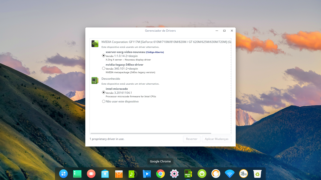

After install deepin, i get noticed some screen tearings, at first i thought the system was without driver, but it cames with the nouveau, as you can see in the image below:
So i changed to nvidia-legacy-340xx-driver, but when i open the X Server i get that error:
"You do not appear to be using the NVIDIA X driver. Please edit your X configuration file (just run` nvidia-xconfig` as root), and restart the X server. "
The system should show me the bumblebee driver, right? Why this dont happens?

It seems that driver-manager doesn't think nvidia-driver support your card, so it stop to show bumblebee-nvidia.
I'll fix this in the next version of mintdrivers.
