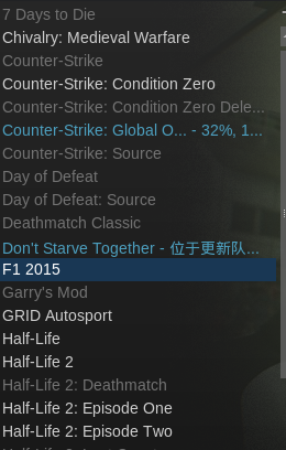

F*CK! After running fsck.ext3 /dev/sda6 in Recovery mode, it worked and my system became r/w.
But right when I opened steam, it continued verifying files of Counter-Strike and the entire OS locked R/O!!!
