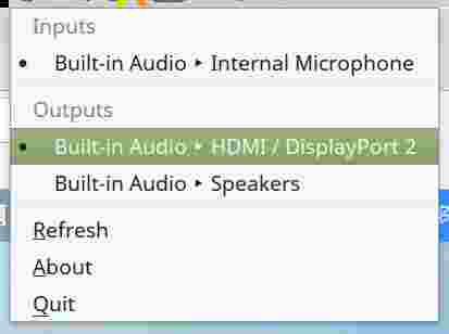

sunnyyuu2
2017-05-28 19:25
我曾经遇到的问题是:用HDMI线将笔记本接到电视上显示的时候,电视没有声音,找到了这个小软件解决,希望能够帮到你。
sudo apt-add-repository ppa:yktooo/ppa
sudo apt-get update
sudo apt-get install indicator-sound-switcher
xjoni
2017-06-05 22:10
https://bbs.deepin.org/post/139306
我曾经遇到的问题是:用HDMI线将笔记本接到电视上显示的 ...
I cant add this repository, error:
The repository "http://ppa.launchpad.net/yktooo/ppa/ubuntu artful Release" does not have a Publication file.
N: Data from a repository like this can not be authenticated and therefore its use is potentially dangerous.
