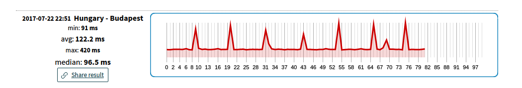

Edited by onur at 2017-8-23 04:00
Along with speed fluctuations there are also ping spikes. I took the screen-shot of a ping test.
While my normal ping to Budapest is around 90-100, the actual ping hits 400.
