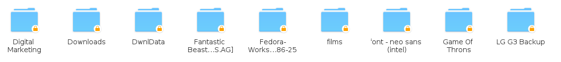

Hey guys,
Recently my folders get lock icon on it like the image.
What the meaning of it?

Hi.
It means that these folders are read-only.

Thanks,
The problem here that I can't copy or paste any folders in any folder!
How can I make folders read and write?
nipos
2017-04-30 04:09
Run sudo dde-file-manager in the terminal.
With root rights you can write on every file/folder

2017-04-30 08:29
Hey, almost all my folders and files are read only now for no reason, can u help me ?
nipos
2017-05-01 01:26
Do you have this problem in your home directory?
If yes,try this: sudo chmod -R 777 /home/YOURUSERNAME/
This gives read,write and execution rights to every file in your home directory and to everyone.
WARNING: Do not do this if this computer has other users!
They could access your files then but if the computer has no other users,it's the easiest solution.

https://bbs.deepin.org/post/138311
If yes,try this: sudo chmod -R 777 /home/YOURUSERNA ...
Unfortunately, it isn't working.
z1z0@Z1Z0:~$ sudo chmod -R 777 /home/z1z0/
[sudo] password for z1z0:
chmod: cannot access '/home/z1z0/.avfs': Permission denied

Please post the content of your /etc/fstab
If root doesn't have writing rights your partition is probably mounted read only.

2017-05-01 05:07
If root doesn't have writing rights your partition is pro ...
I'm sorry for bothering you,
How can I take root access on all partition?
nipos
2017-05-01 05:31
You should have root access everywhere.
The only thing I know when you haven't root access is when the partition is mounted read-only
That can be changed in the /etc/fstab file.
The only thing I know when you haven't root access is when t ...
How to change it, please?
nipos
2017-05-15 02:07
Please post the content of your /etc/fstab file.
I must be sure first that this is really the problem but I think so.
