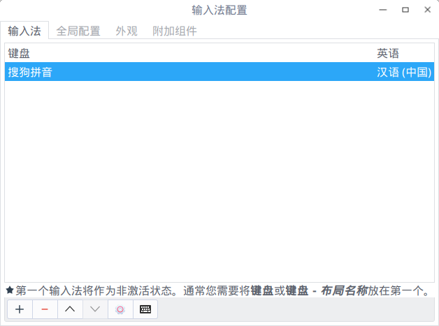

wanywhn
2017-04-17 16:10
sudo apt-get install  sogoupinyin then reboot(or re-login) ,when fcitx shows something like "sogoupinyi" or "搜狗拼音",it should worksBTW,if apt-get can't locate package "sogoupinyin"  although you have done apt-get update,you might have to change you time zone to "shanghai" . then you can change to your own time zone.
cycool
2017-04-17 17:56
Does sogou supports zhuyin and 繁體 as well?
wanywhn
2017-04-18 14:50
繁体 supports. in the sogoupinyin's setting.注音 don't support in sogoupinyin.
