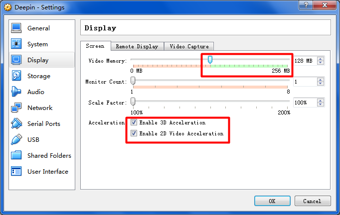

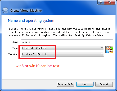

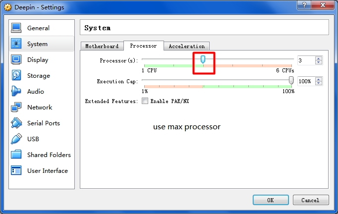

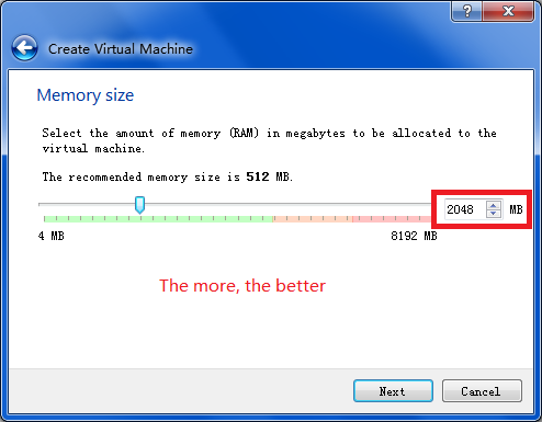

comzhong
2017-04-13 01:55
I think vitualbox's setting is very important,it's default setting is not good for run deepin. This is not best setting, only be Referenced.
https://bbs.deepin.org/post/133490#

comzhong
2017-04-13 02:06
https://bbs.deepin.org/post/137521

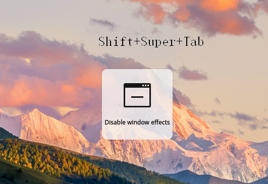

rdlg
2017-04-13 02:41
try disable window effect

la******ng@outlook.com
2017-04-13 08:00
There will be tearing issue if you disable the window effect, so do not disable it.
