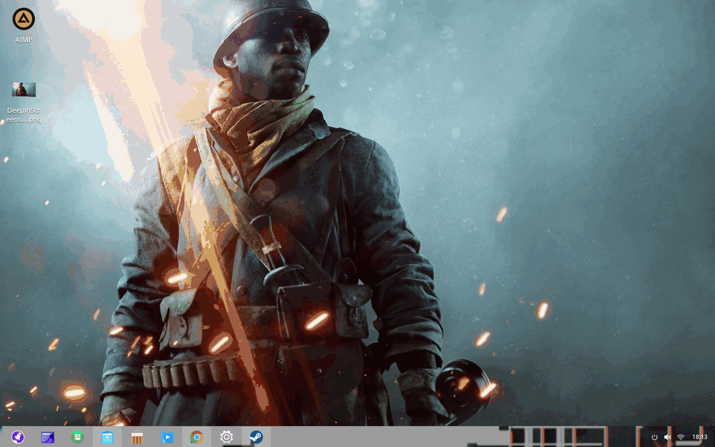

Hey, so since i installed Deepin 15.4 BETA, the dock, the settings menu, the notifications and every ui that opens has this weird background.
Before installing deepin on my hdd, i installed it on a virtual box and everything ran fine.
Anyone had some similar bug?

I thought this happens only with DDE on archlinux. so what's your video card ? try execute `lspci -v |grep -E 'VGA|3D' -A12`

Never mind, i fixed it by installing my GTX 750 ti drivers.

The problem is in the selected language, if you put the language Americam English does not have the bug, if you move to any other language the video bug happens.
Http://feedback.deepin.org/feedback/detail/2508

thanks for the feedback, it never occur to me that swiching lang will brake rendering...
