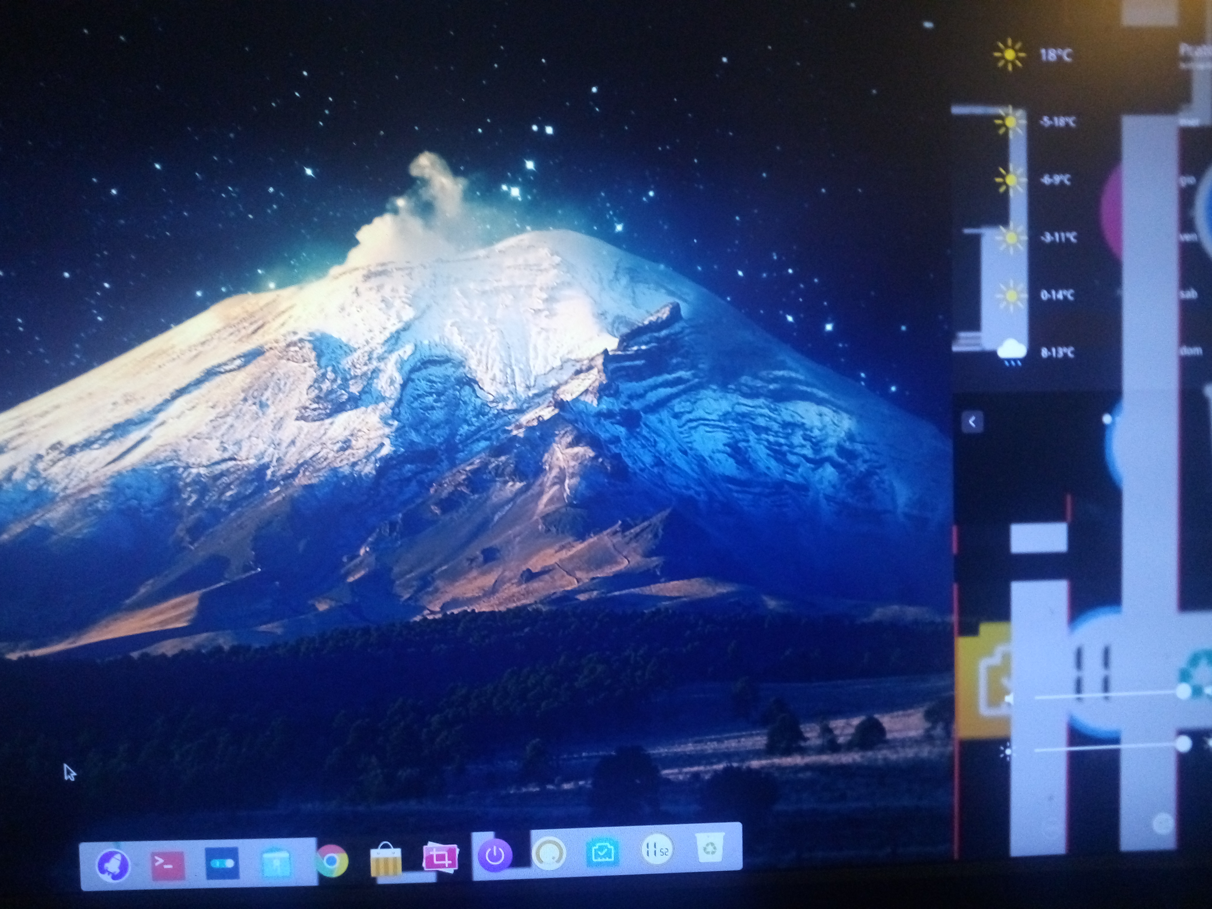

Hello everyone, I installed the 15.4, finding it much more fluid with the previous generation, unfortunately I found several graphical glitches in the dock and in the Control Center.
I think because of the lack of proper driver for my Nvidia GTX 660Ti. In fact I can't install it from the Driver Manager from the downloaded file from the nvidia site.
Does anyone have the same problem? how can I solve it?
PC Configuration : cpu: Intel Core i7 3770K (overclocked) - mb: Gigabyte GA-H77DS3H - ram: 12GB DDR3 - 3HDD x 1TB - sk video: Gainward nVidia GTX 660Ti - case Areocool StrikeX Xtreme White - Corsair GS800 (800W) - mouse and keyboard Logitech K120 - monitor : 1 full hd samsung + 1 full hd philips

I don't have those bad glitches , the only thing so far is that the dock will take a little while to show up ; but yeah i can not update to the Nvidia  drivers ,  it gives a list of files  of  files that their dependencies can not be resolved :
nvidia-driver: Depends: nvidia-driver-libs (= 367.57-1+deepin) but 367.57-1+deepin is to be installed
               Depends: nvidia-driver-bin (= 367.57-1+deepin) but 367.57-1+deepin is to be installed
               Depends: xserver-xorg-video-nvidia (= 367.57-1+deepin) but 367.57-1+deepin is to be installed
               Depends: nvidia-vdpau-driver (= 367.57-1+deepin) but 367.57-1+deepin is to be installed
               Depends: nvidia-alternative (= 367.57-1+deepin) but 367.57-1+deepin is to be installed
               Depends: nvidia-kernel-367.57 but it is a virtual package
the open sources drivers work ok for me and the best part is that all my font problems are gone

I also tried this method, unfortunately nothing, seems to be a problem Xserver.Xorg.
However, for now I have to remove Deepin, too many young, I return to the most powerful and stable Arch Linux, for now... when you exit the Deepin 15.4 Output Stable, I'll try again.

I've the same problem, but  i don't have any idea how to solve this!

I have the same problem and I am using a R9 270. Anyone got a solution for this?

Hi, I have the same problem, I return to Deepin after trying another distros, so I decided to try the beta, unfortunately I found this glitch, Help please!

I had the same glitch, i fixed it after installing my 750 ti Drivers, so that is the only solution i think.

Hi everyone, I found a solution that worked at least for me:
I've installed deepin with spanish as system language because is my native language, but in this archived thread an user suggest to change the system language to english, so that's what I did an it has worked, I  don't mind using the OS in english so it's fine for me.
Hope it helps and soon they fix this issue.
https://bbs.deepin.org/archiver/?tid-136949.html

The graphics glitches have been fixed in 15.4 RC2 (Intel CPU i5 7th generation / Intel integrated GPU).
