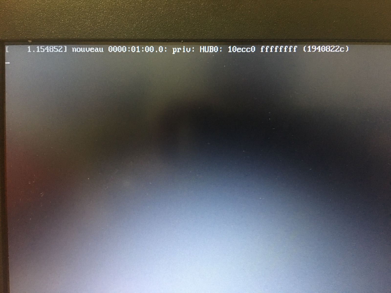

Hello, I'm trying to install Deepin 15.3 on my Asus laptop (i7 6700HQ, Nvidia GT960M) but after grub, the screen goes black.
I've tried setting parameters like nomodeset, nouveau.modeset=0, nouveau.blacklist=1 but nothing, black screen after grub.The usb is not the problem, because I have installed it in other pc (intel graphics) without problem.
Thanks for your help and sorry for my english.The screen says: nouveau 0000:01:00.0 priv: HUB0 10ecc0 ffffffff (1940822c)

What's the model of mainboard in your laptop
黑色
2017-02-01 23:06
GT960M only or Dual card  optimus?If you still got a intergrated video card, what about blocking the Nvidia model via bios settings?
The model is ASUS GL552VW

GT960M only or Dual card  optimus?If you still got a intergrated video card, what about blocking th ...
Dual card, but i've search in the BIOS and can't find the option to disable nvidia card...

weird.......it should work properly on a GT960m video card as many have done so.........problem may be your CPU,i7-6700hq is  a 6th gen chip which has not been well supported by the current kernel ,according to the officeial,try out this version if  you may.....    https://pan.baidu.com/s/1jHRFrIe

weird.......it should work properly on a GT960m video card as many have done so.........problem may  ...
Yes, maybe it's 6700hq the problem, yesterday i've tried ubuntu and the same happens... thanks for your help! I will try the version you told me
Thank You very much, this iso works!
I have some minor issues with the startup time or changing background, but minor bugs, i will try to resolve them, thanks again!
