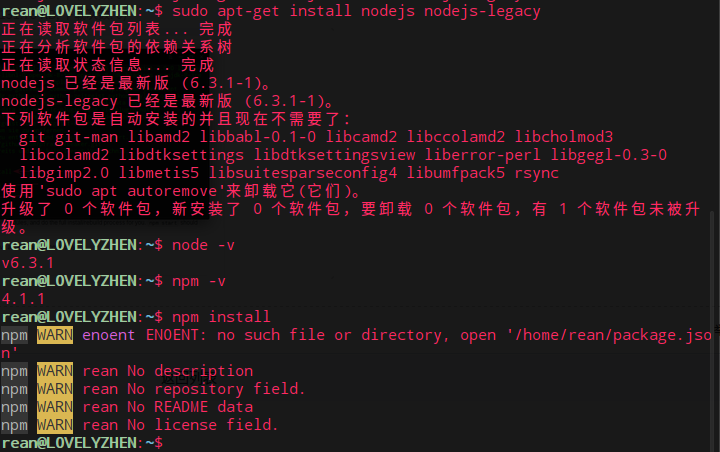

first ,  you should install nodejs package :
  1. sudo apt-get install nodejs nodejs-legacy
Copy the Code
and then change to the source code dir :
  1. npm install
Copy the Code

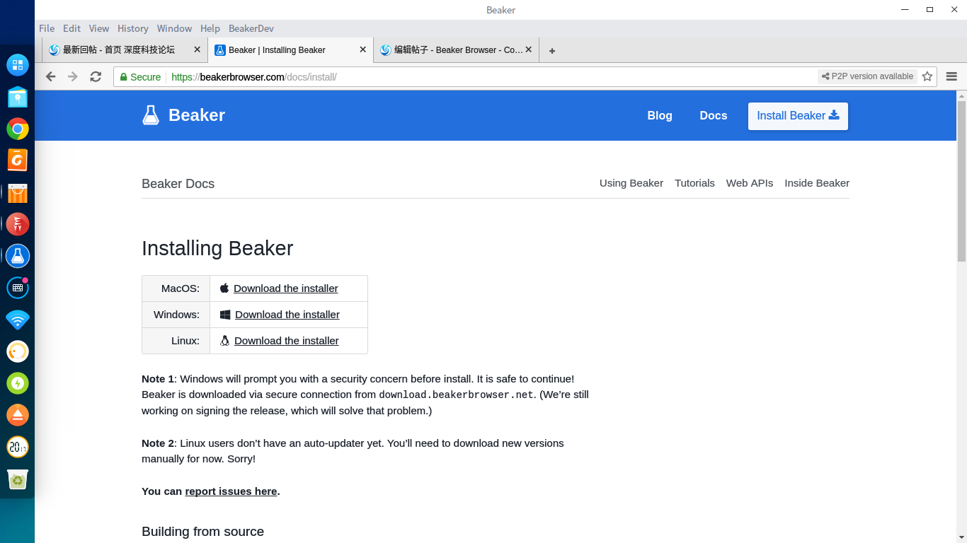

you can try the appimage package.
https://github.com/beakerbrowser/beaker/releases/download/0.7.10/beaker-browser-0.7.10-x86_64.AppImage
