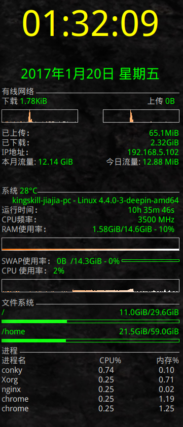

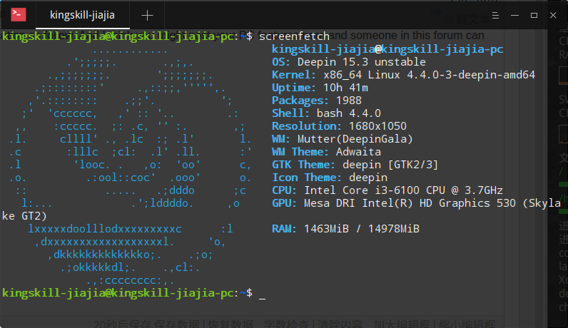

kingskill
2017-01-20 09:38
https://bbs.deepin.org/post/134264
Edited by savanweylyn at 2017-1-19 17:51
Ok,probably I misunderstood your question. This's my specification as follow. And I think you might post your PC features here and someone in this forum can help you exactly.

kingskill
2017-01-21 01:31
The pic is still running....
