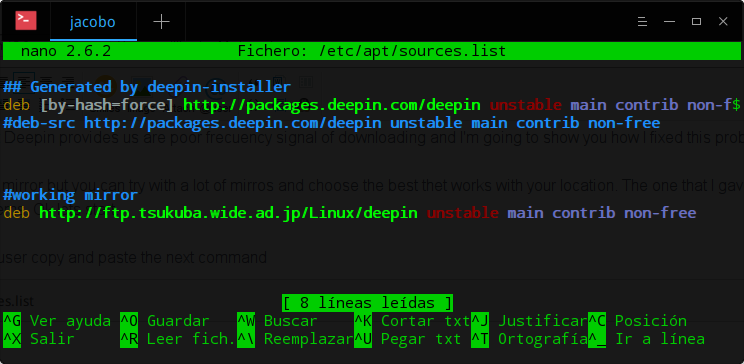

As you know the mirrors that Deepin provides us are poor frecuency signal of downloading and I'm going to show you how I fixed this problem.
I recommend you to use this mirror but you can try with a lot of mirros and choose the best that works with your location. The one that I gave you is fully tasted and so far hasn't given me problems. Ok lets start.
1. Open the terminal as a root user, copy and paste the next command
  1. nano /etc/apt/sources.list
Copy the Code
It will appear something like that
2. Erase everything then copy all including the hashtags and paste the next text in the console.
  1. ## Generated by deepin-installer
  2. deb [by-hash=force] http://packages.deepin.com/deepin unstable main contrib non-free
  3. #deb-src http://packages.deepin.com/deepin unstable main contrib non-free
  4. #working mirror
  5. deb http://ftp.tsukuba.wide.ad.jp/Linux/deepin unstable main contrib non-free
Copy the Code
Press CTRL+O to save changes, press ENTER next press CTRL+X to Exit.
3. Now you're going to type the next commands to lock lists, dpkg and cache archives.
  1. rm -r /var/lib/apt/lists/lock
  2. rm -r /var/lib/dpkg/lock
  3. rm -r /var/cache/apt/archives/lock
Copy the Code
4. Lets update now using the next command without using sudo because we are running as a root.
  1. apt-get update
Copy the Code
And by doing all of this the problem have to be solved. You can check that now is downloading faster by going to Deepin Store and Download a program or App and you will see that it is going more faster

How about using vim?

If you use Vim to edit the sources list instead of the terminal it's ok but you have to do the step 3 and 4 in the terminal.

Why not use the GUI to do this? I have used it to set my nearest mirror (it even has the speed test results) with minimal problems

Maybe you can try Chinese mirrors!
USTC mirror:
  1. echo -e "deb [by-hash=force] http://mirrors.ustc.edu.cn/deepin unstable main contrib non-free \ndeb-src http://mirrors.ustc.edu.cn/deepin unstable main contrib non-free" |sudo tee /etc/apt/sources.list &&sudo apt update
Copy the Code
or
Alibaba aliyun mirror:
  1. echo -e "deb [by-hash=force] http://mirrors.aliyun.com/deepin unstable main contrib non-free \ndeb-src http://mirrors.aliyun.com/deepin unstable main contrib non-free" |sudo tee /etc/apt/sources.list &&sudo apt update
Copy the Code
I tested USTC mirror in US vps ,3Mib/s . very fast!
