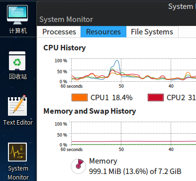

Hi,
i have installed Nvidia propietary driver through driver manager.
[attach]10677[/attach]
Now when i open Nvidia-settings i am getting an error message as shown
[attach]10678[/attach]
The lspci | grep VGA is showing only Intel graphics installed.
It seems Nvidia driver is not installed properly. What should i do?
Please help.
Tony
