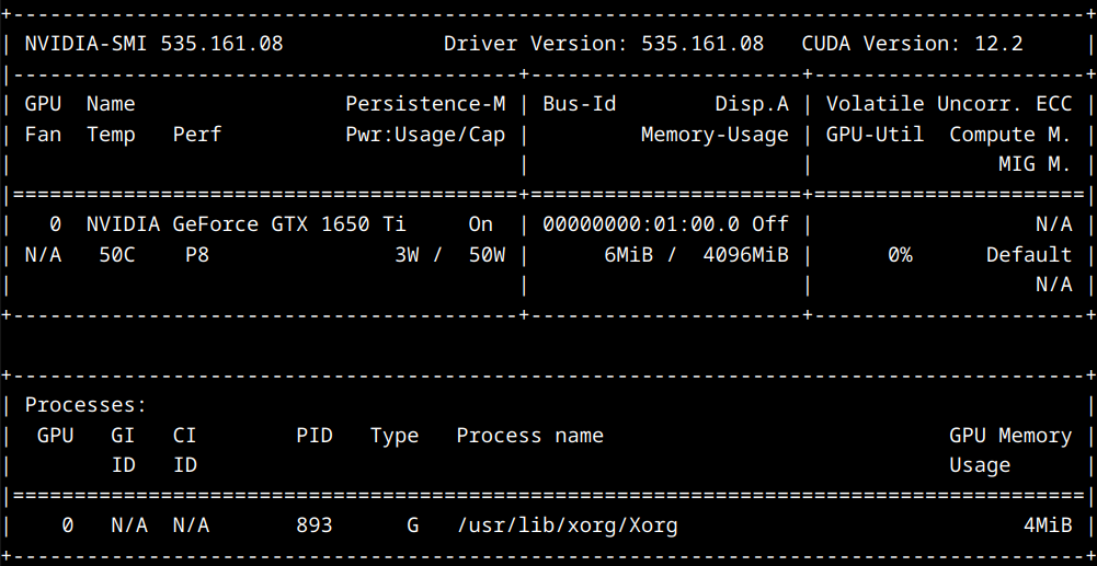

Could you please provide the output of the following commands for further analysis:
  • nvidia-smi
  • sudo dmesg | grep nvidia
  • /var/log/Xorg.0.log
This additional information will help diagnose and solve the problem more effectively. Thank you for your patience and cooperation.

nvidia-smi

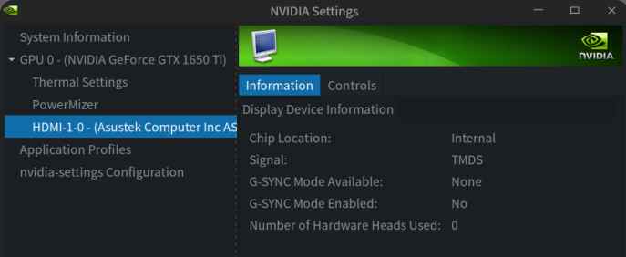

  2. Check NVIDIA Configuration: Open the NVIDIA X Server Settings by typing nvidia-settings in the terminal and check if both monitors are detected. A screenshot of this window would be helpful.

NVIDIA Settings
After rebooting, open the NVIDIA X Server Settings by typing the following command in the terminal:
nvidia-settings
Check if both monitors are detected. If the issue persists, please provide a screenshot of this window.
