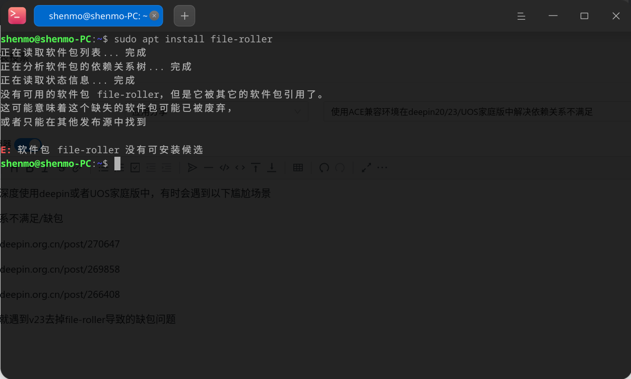

    Today, for instance, I faced a missing package issue due to the removal of file-roller in v23:

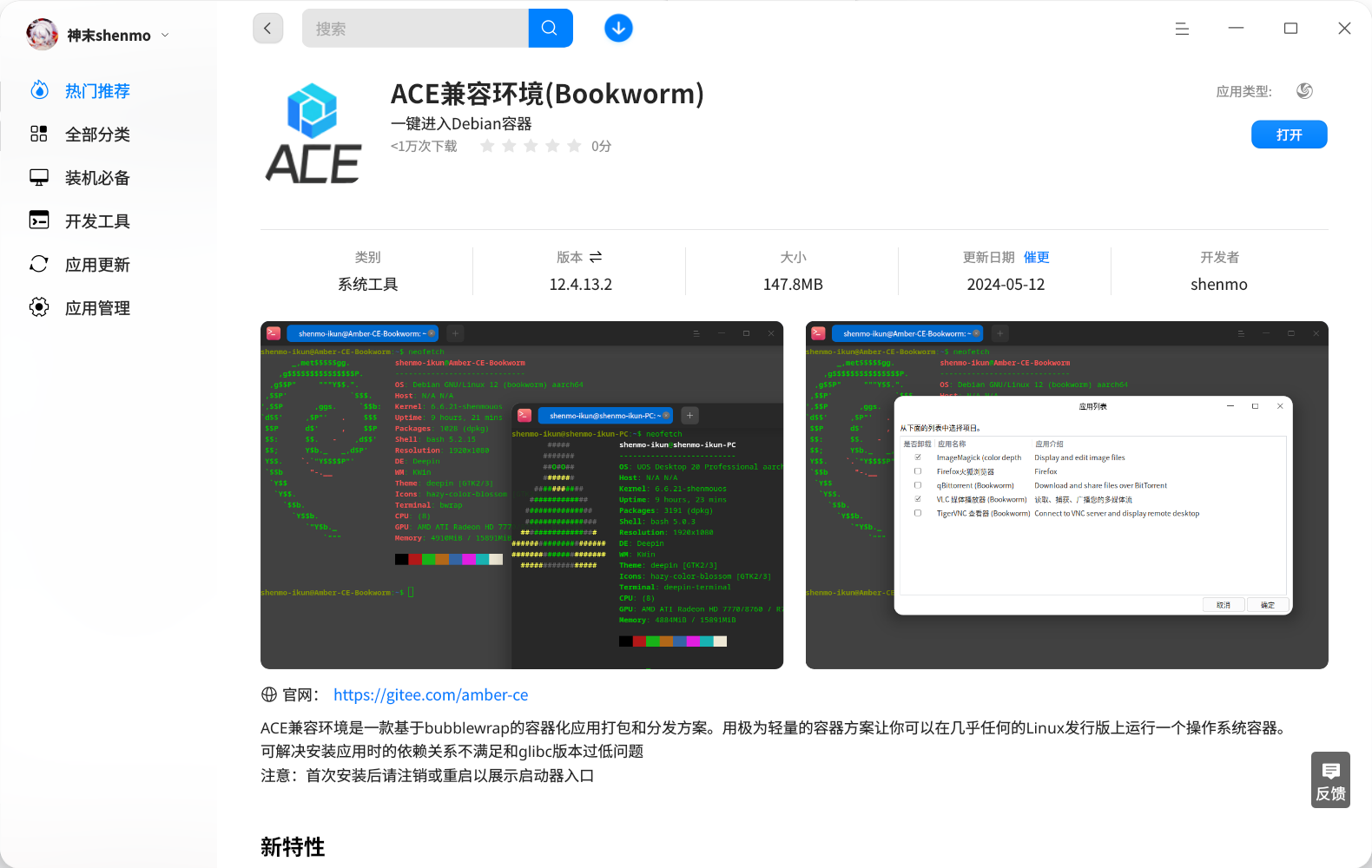

    1. Install the compatibility environment:
      You can install it from the app store:(Please search AmberCE(Bookworm) if your language is English)
      Or manually:
      Manual Installation Guide

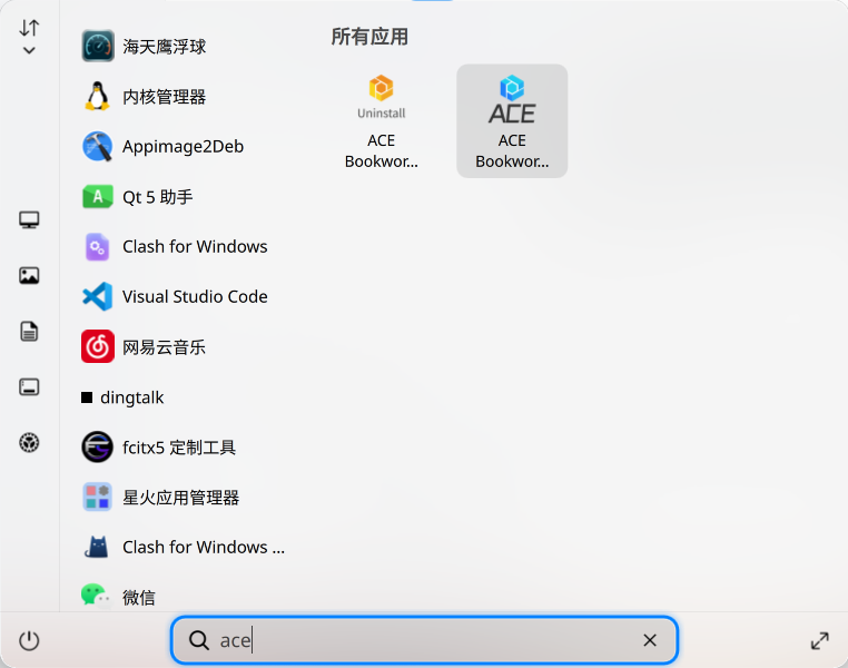

    2. Open the compatibility environment from the launcher:
    ACE Bookworm includes a Debian12 environment for easy application installation.

    1. Package does not exist:
      The file-roller archive manager is not in the deepin 23 software repository. Attempting to install it via apt install file-roller will fail.

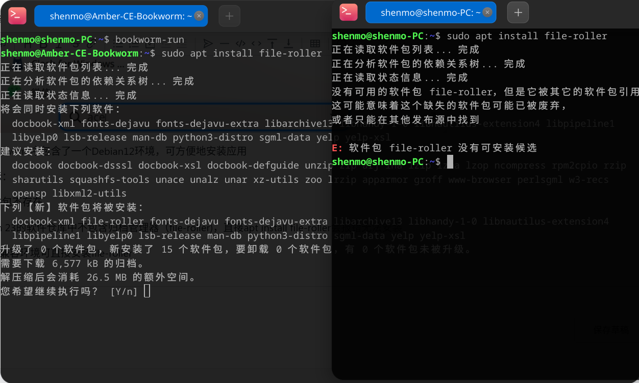

      With the ACE compatibility environment, file-roller can be installed directly (if it's the first installation of ACE compatibility environment, a restart or desktop logout may be required to display the entry in the launcher):

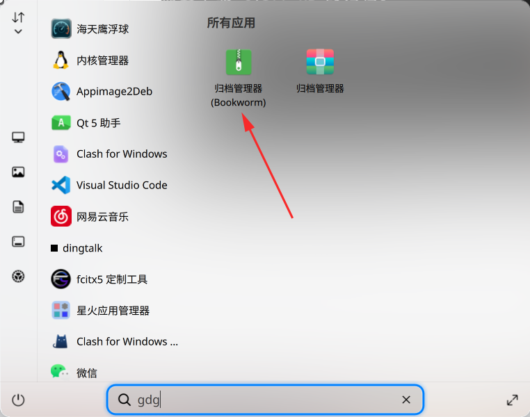

      Once installed, file-roller can be used to open compressed files:

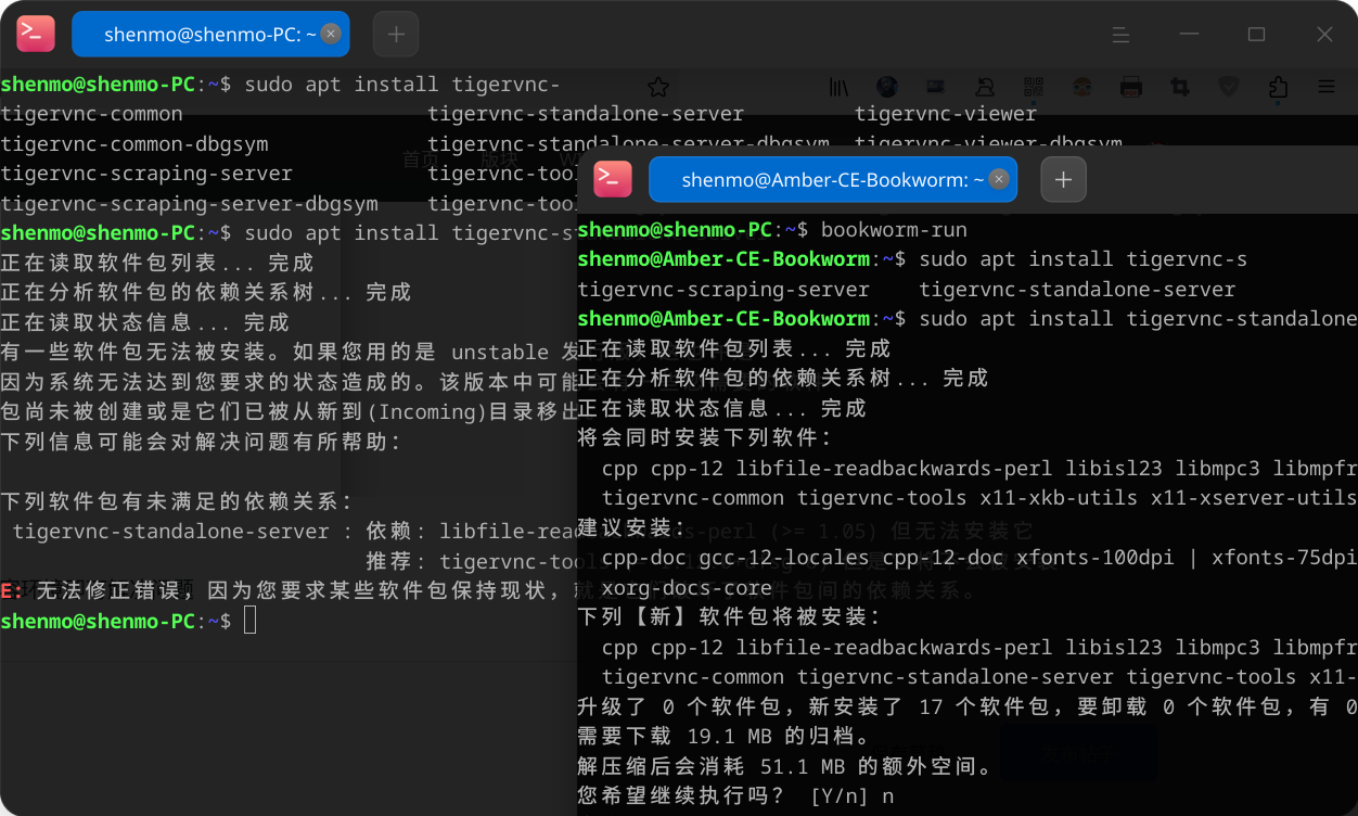

    2. Dependency issues:
      Some packages have broken dependencies, making them impossible to install. This can be resolved with the ACE compatibility environment:

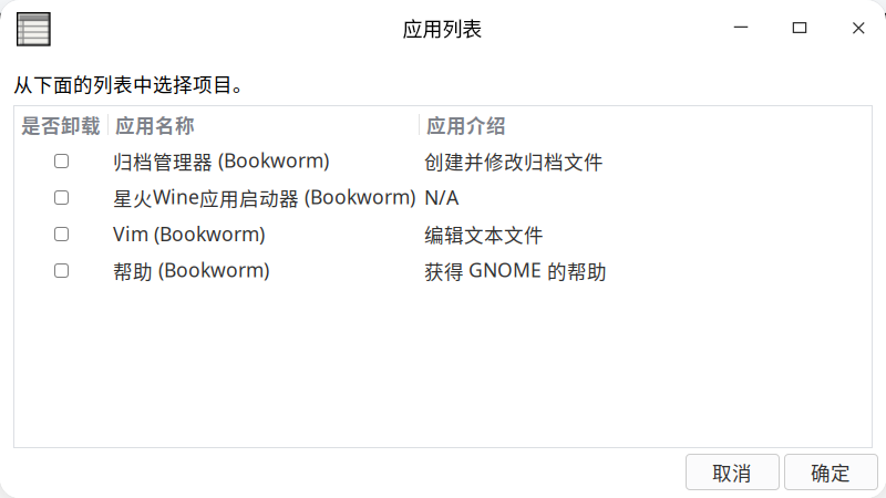

      • Installed applications cannot be directly uninstalled via right-click. Apart from typing commands within the ACE compatibility environment, you can also use the provided uninstaller to remove applications:
