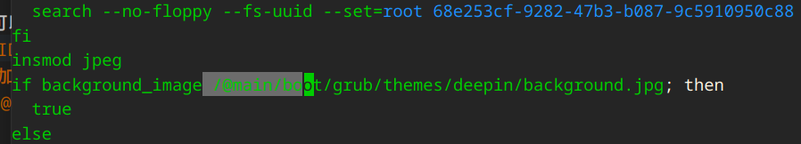

Replace the UUID of the initial system with the UUID of the btrfs partitation by searching.
Observe the reference to the absolute path of the system in the grub.cfg file and add "/@ main" before "/" to indicate that the path is the path in the subvolume after modification.
Add "rootflags=subvol=@main" to the linux line to indicate that the @main subvols would be boot.
linux /@main/boot/vmlinuz-6.1.32-amd64-desktop-hwe root=UUID=68e253cf-9282-47b3-b087-9c5910950c88 ro splash quiet rootflags=subvol=@main DEEPIN_GFXMODE=$DEEPIN_GFXMODE
initrd /@main/boot/initrd.img-6.1.32-amd64-desktop-hwe

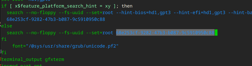

Enter to the/mnt , find the boot and deepin directories, and modify the grub.cfg file. Change "search.fs_uuid" to the UUID information corresponding to the btrfs parent volume, and add the path corresponding to the subvolume to "set prefix"

Modify the grub.cfg file in the @sys subvolume, and add "rootflags=subvol=@sys" to the linux line to indicate that grub boots the @sys subvolume in the btrfs parent volume, and both initrd and linux paths in the boot entry need to be modified to the current system @sys subvolume
