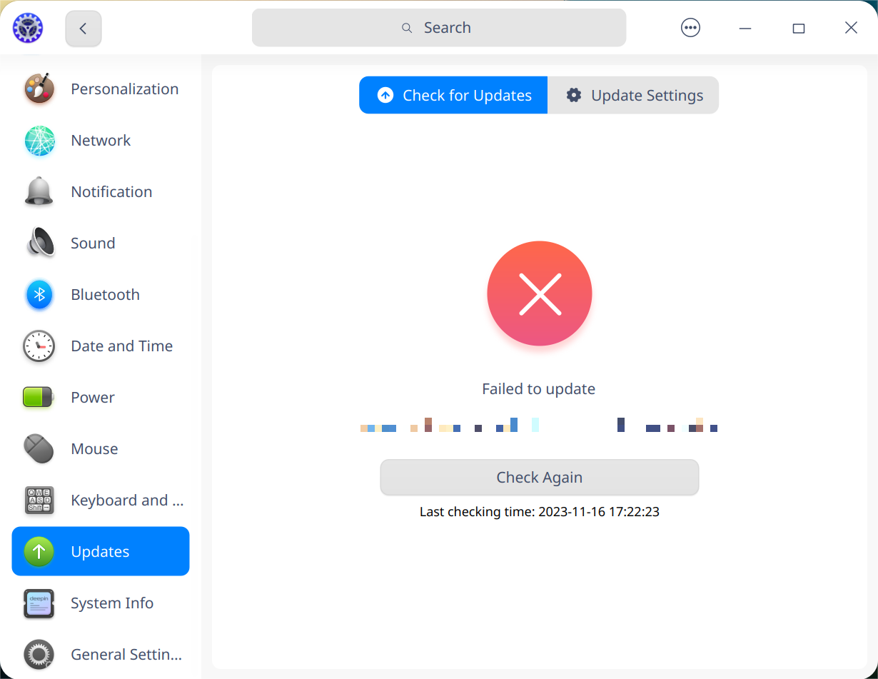

The system update fails or reports a dependency error.

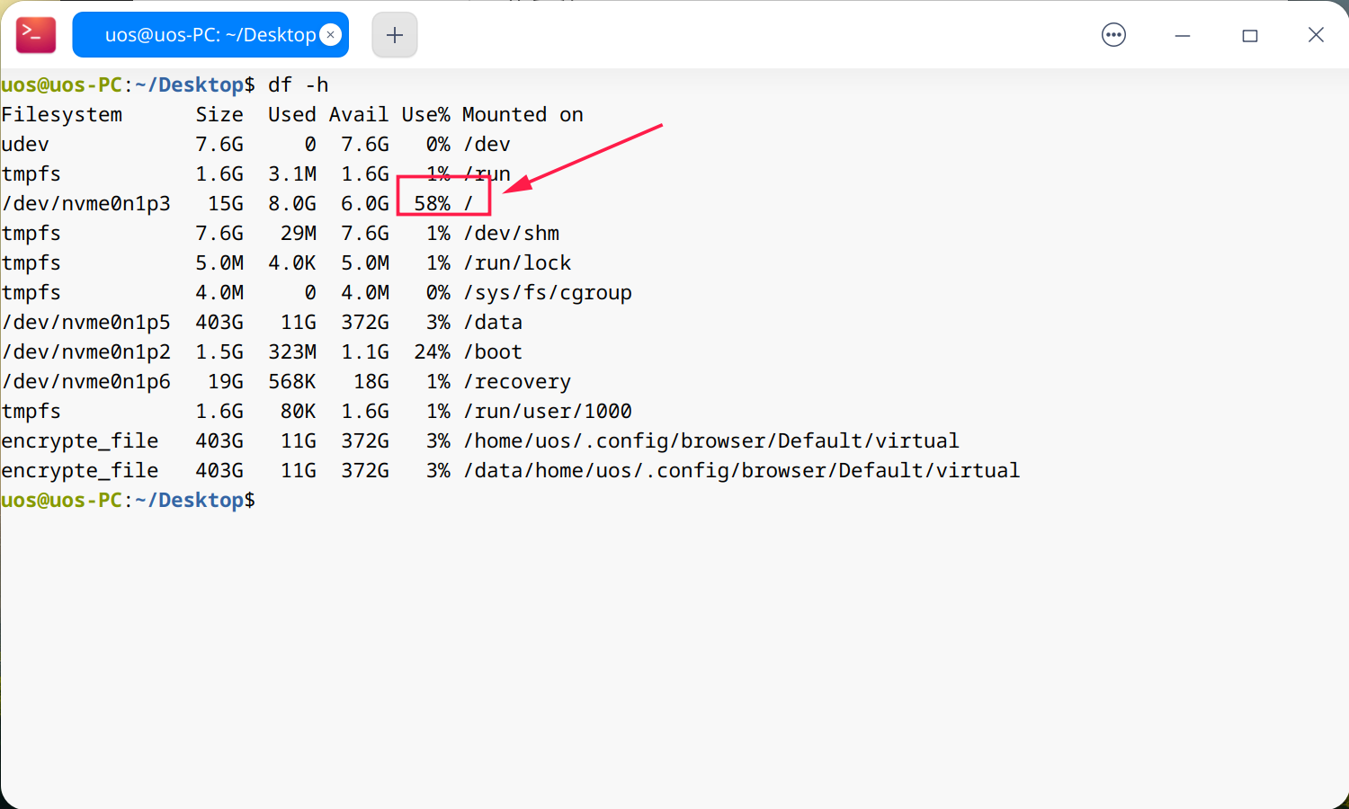

1. Use the command "df -h" to check if there is sufficient disk space. If there is not enough space, please clean it up (you can use the Security Center to clean up or manually delete some files and uninstall unnecessary software).

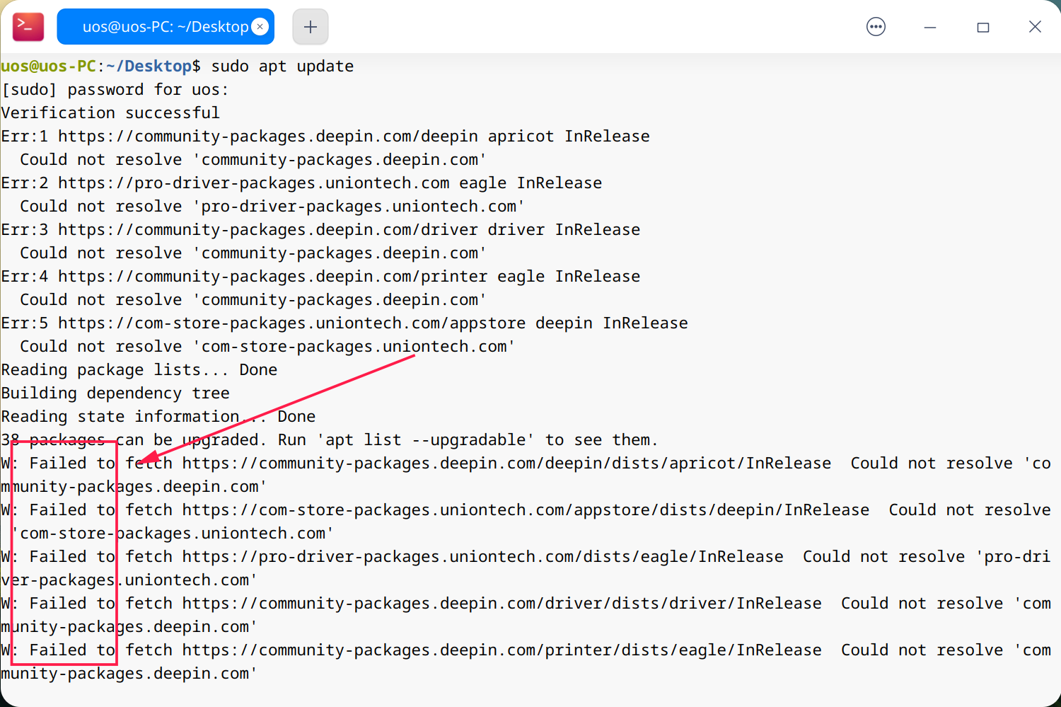

2. If there are third-party repositories in the system, you need to remove them first and switch back to the original system repositories (changing repositories can cause irreversible system issues, so it is not recommended). Then, in the terminal, run "sudo apt update" to check if there are any error logs in the output.
- If "Failed" appears, please check if the network connection is normal.
