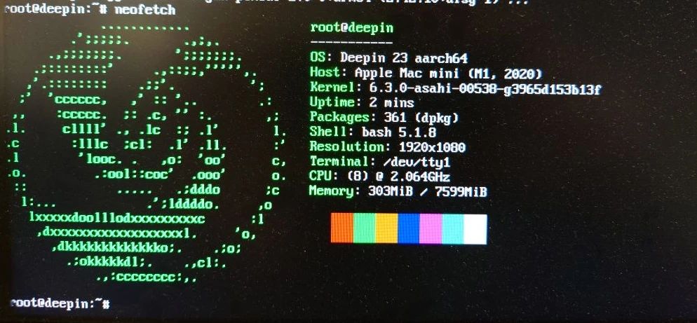

Adapt to the minimal deepin environment (command line only)
First of all, we package the M1 Debian rootfs package script based on m1-debian, first change the source of the debootstrap rootfs environment from debian to deepin, when this step is reached, it can be successfully started, and then try to replace the apt software source with the community source of deepin V23 , It was found that a kernel panic occurred during the system startup phase. After analyzing, searching and debugging, nothing came up.
After further analysis and debugging, finally, the community source was replaced with the CI source and rootfs was generated. At this time, the kernel panic error disappeared, and the deepin system was successfully entered. It is guessed that the relevant library version required by the upstream kernel is relatively high, and the software package of the current Community source cannot meet the requirements. Therefore, it is temporarily necessary to use the CI source for adaptation.
At this stage, except for Asahi-related packages that also need to use the m1-debian project, other debian sources can be replaced with deepin sources, as shown in the figure below, the smallest deepin system environment can already be started.

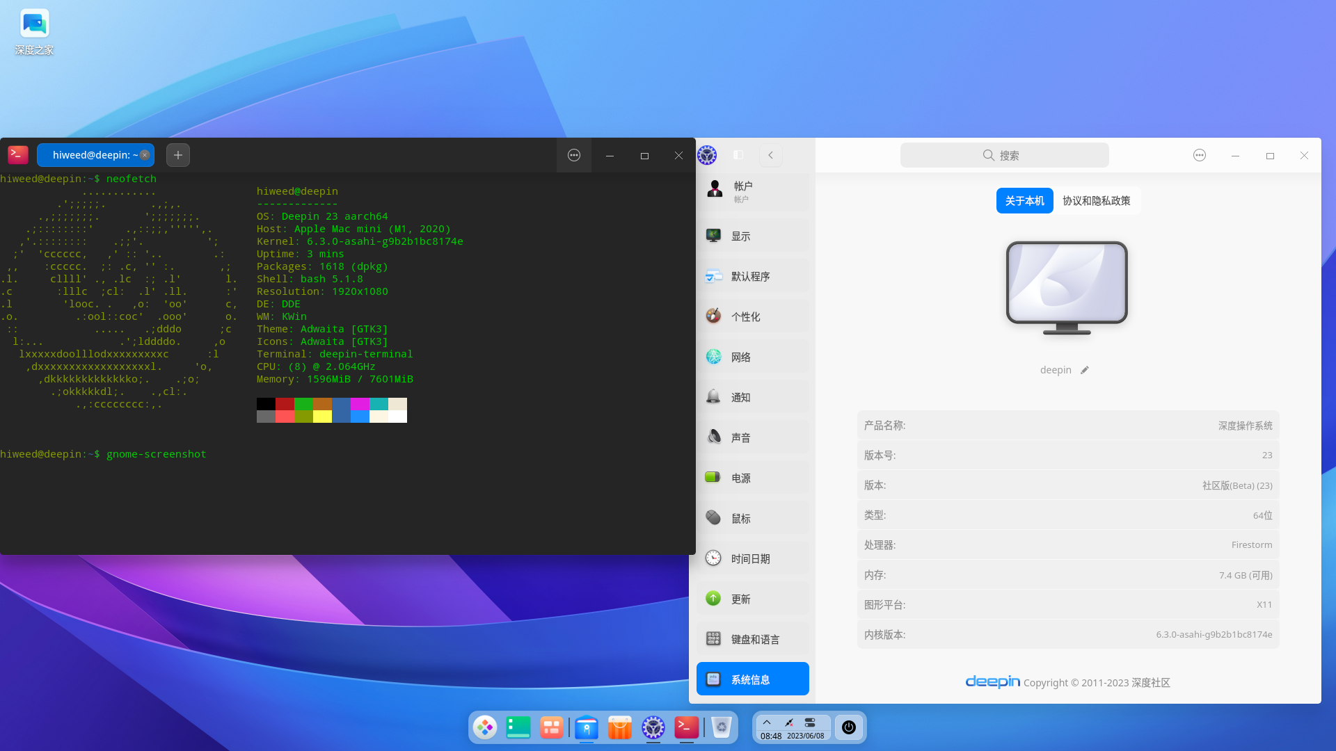

Adapt to the basic DDE desktop environment
At the beginning, when installing the DDE desktop environment in the deepin environment, you will encounter the problem of mesa package dependency. Because the mesa package adapted to m1-debian is based on the Debian bookworm environment, it cannot be used directly in the deepin environment. Therefore, deepin-m1 SIG decided to repackage mesa in the deepin environment and build a warehouse independently. Because they have been independently built, so at this stage, the kernel, m1n1, uboot and other components are also repackaged and added to the warehouse.
After solving this problem, the next process will be smoother. Install the mesa and DDE desktop environments, and after solving some strange missing package dependencies, as shown in the figure below, we can start the familiar desktop environment.

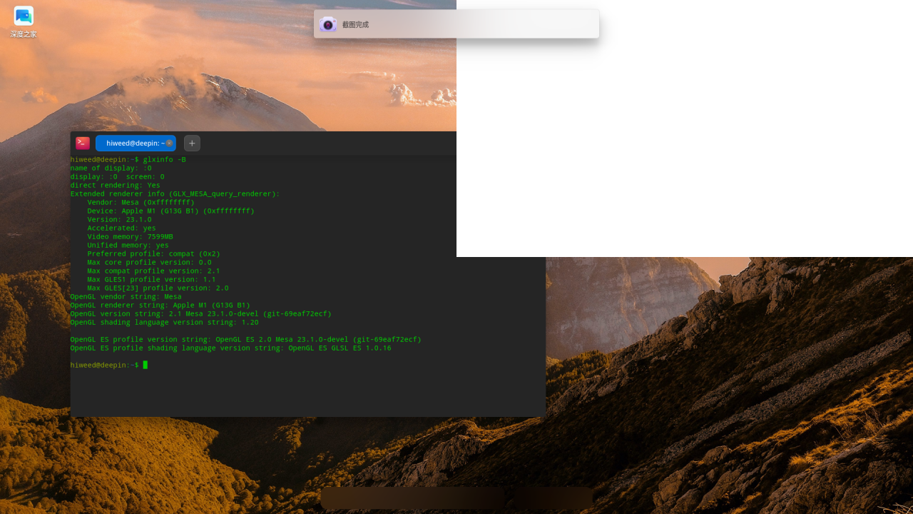

However, neither sound nor GPU hardware acceleration is available on top of the current desktop environment. During debugging, we have tried various kernel parameters and kernel compilation scripts of Asahi Linux distributions to customize and adapt the kernel. Unfortunately, judging from the current debugging results, our self-compiled kernel still cannot solve the above problems.
When using the kernel provided by the m1-debian project, although GPU hardware acceleration can be enabled, there will still be problems with the window management. For example, there are abnormal white blocks, and the dock displays abnormalities. This may require adaptation of the core and the window tube.
This problem needs further analysis, debugging and investigation of the root cause of the problem. Currently, the project has been publicly released on github (https://github.com/deepin-community/deepin-m1), and interested developers can try it out. If you want to install directly on Mac, you can also use https://ci.deepin.com/repo/deepin/deepin-ports/deepin-m1/deepin.install script directly.
