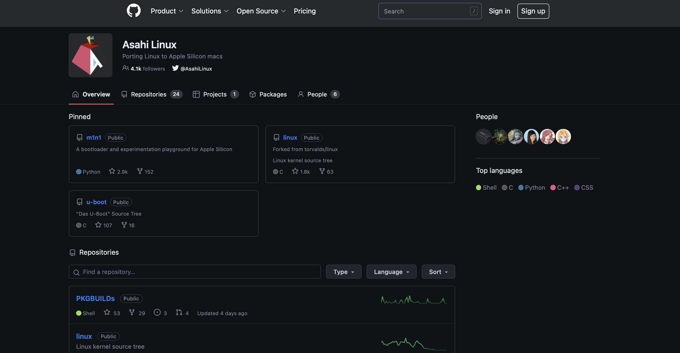

Asahi Linux is a project and community dedicated to adapting Linux to the Apple Silicon platform. Within this community, several Linux distributions have already been successfully adapted, including Alpine Linux, Debian, Fedora, Gentoo, Ubuntu, and more. For specific details, please refer to: https://github.com/AsahiLinux
In order to let everyone understand what our adaptation has done, first of all, we will introduce the process of using the Asahi Linux project to install and start Linux on the Apple Silicon platform:
Step 1
First, run the installation script on Mac OS. This installation script will pull the installation configuration and rootfs installation package, partition the remaining disk space, and flash the bootloader (m1n1 and UBoot) and rootfs for the subsequent installation process.
Step 2
Then, turn it off and start it again, and enter the flashed startup item. At this time, the work of setting the installed Linux distribution as the default startup item will be performed.
Step 3
After restarting the computer, the system will enter the flashed bootloader, which is m1n1. m1n1 will load the bootloader of the next UEFI system according to the settings, usually UBoot. UBoot will decide whether to start the operating system directly or start Grub according to the configuration file. From here, the subsequent process is similar to the normal UEFI system.
Step 4
Finally, depending on the installation method of different distributions, the first startup may enter the configuration wizard. For example, the official ArchlinuxARM will boot into their specially customized calamares installer.
docs(https://github.com/AsahiLinux/docs/wiki/SW%3AAlternative-Distros)
Adaptation Process
Step 1
Step 2
Step 3
Step 4
