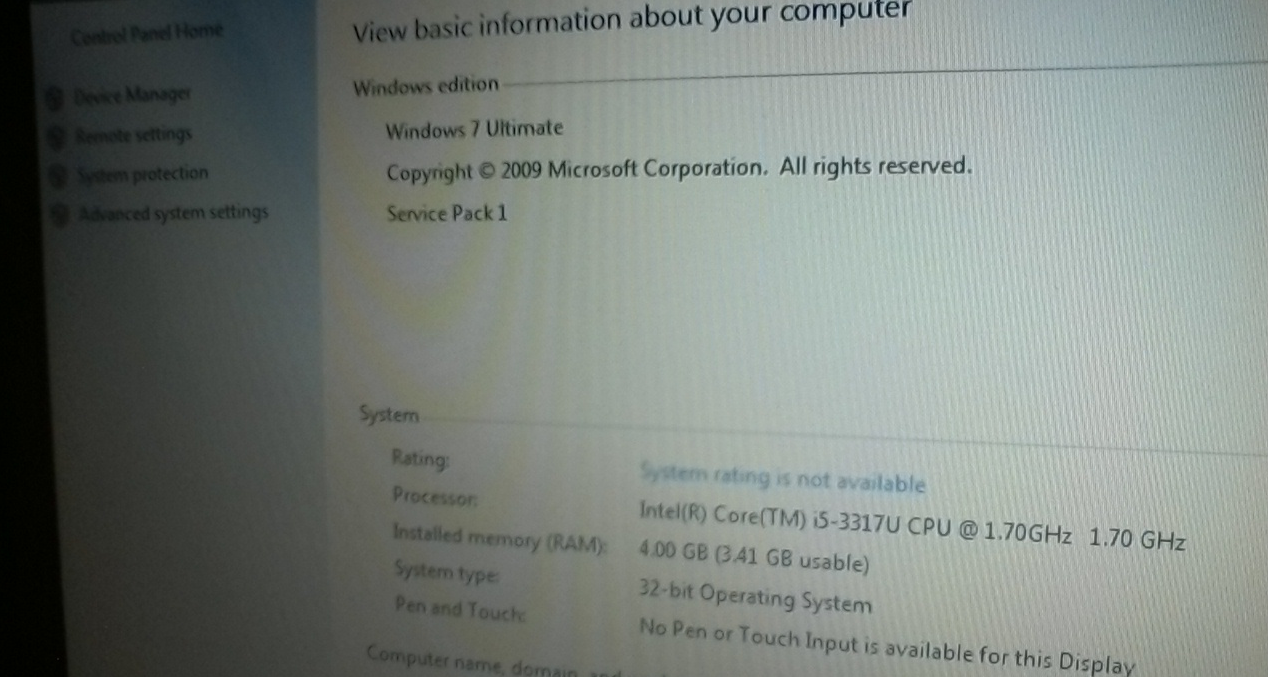

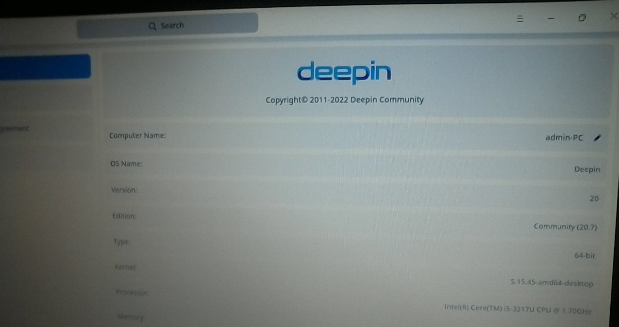

This system works like a GEM on Deepin 20.7! The reason I chose the 3rd gen Intel Core i5 motherboard is because I want this computer to run anything from Window XP, 7, 8, up to 10 (and possibly 11 too).
OMG, upon fresh install of Deepin 20.7 to multi-boot along side Windows 7 and XP, I wasn't expecting much. After all this type of computer came out in 2012/2013 so should be considered pretty out-dated but still plenty useful.
I was surprised the sound works just like that. Also what surprised me even more, I plug in a Wifi 4 USB dongle made by Belkin. It's even using draft version of WiFi 4 (not completed finalized version) and works just like that.
I had problems with Deepin 20.7 on Huawei Matebook D 15 (2021 version). The sound doesn't work only Bluetooth sound to headset, but the wifi is fine. Deepin 20.7 certainly works like a charm on my newly assembled mini-ITX PC!
I need to evualate more/other USB wifi dongles on this system to see if they work with Deepin 20.7 without needing drivers, but OMG WiFi4 (draft version) from some obscure manufacturer working like that without drivers? It's unbelieveable!

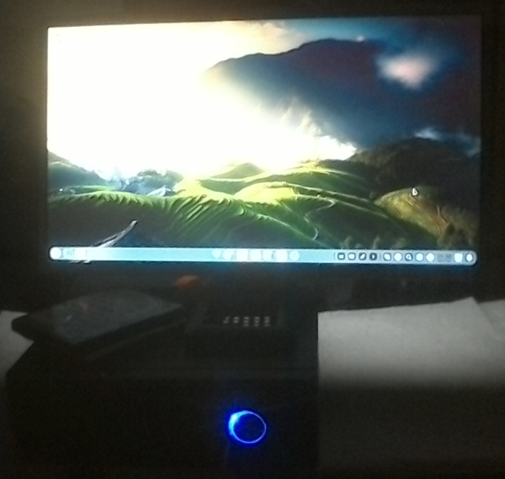

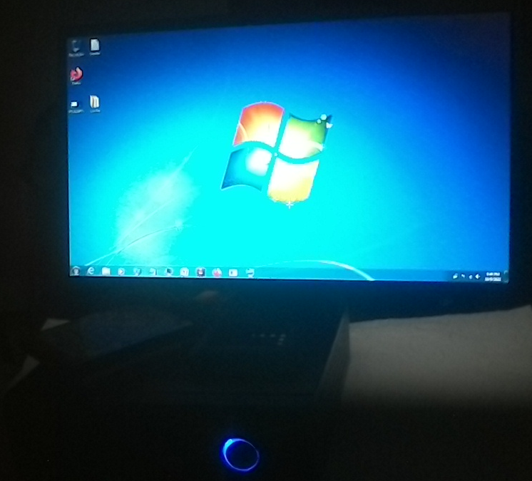

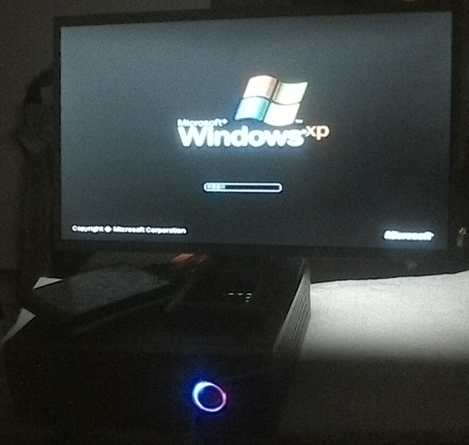

The nice thing about mini-ITX systems is you can connect a laptop LCD screen (mostly TN screens for the older motherboards not the IPS screens that require newer technology) without needing a separate LCD controller or power source. If the motherboard has LVDS (or eDP for newer boards) pins, then can connect laptop screen directly to the board using LVDS/eDP cable!
You can see here my mini-ITX PC has 14 inch laptop TN screen with native resolution 1600x900 attached to it. The HDD sits outside of the PC case next to the screen stand because I want to be able to rapidly swap the HDD. Computer runs my three most favorite OSes: Windows XP, Windows 7, and Deepin 20.7
I will admit that my current main OS is Windows 7, BUT not by choice! The purpose of having a PC is not for entertainment, not for web browsing, not for editting office documents. The point of having a personal computer is allow you to create custom software. I have never taken a programming course in school. But that doesn't stop me from using self-made software as the main activity on the computer!
I'm currently tied to Windows 7 because .NET application are too easy to create in Visual Studio. Soon as Deepin offers an alternative to Microsoft .NET for casual programming (doesn't have to be a complete fancy enterprise solution, but just something simple for enthusiasts and hobbyists), I will say goodbye to Windows 7 and only use it to file my taxes (because obviously the tax software can only run on Windows)!
