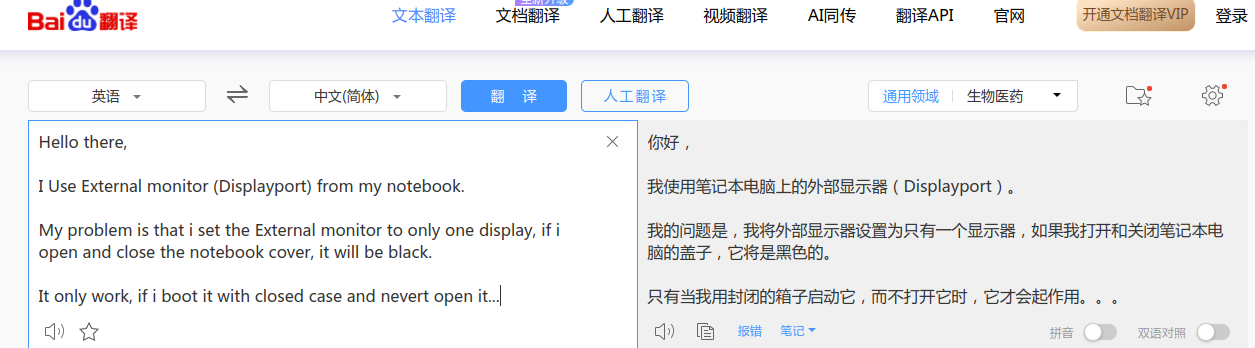

Hello there,
I Use External monitor (Displayport) from my notebook.
My problem is that i set the External monitor to only one display, if i open and close the notebook cover, it will be black.
It only work, if i boot it with closed case and nevert open it...
