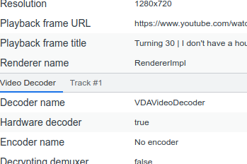

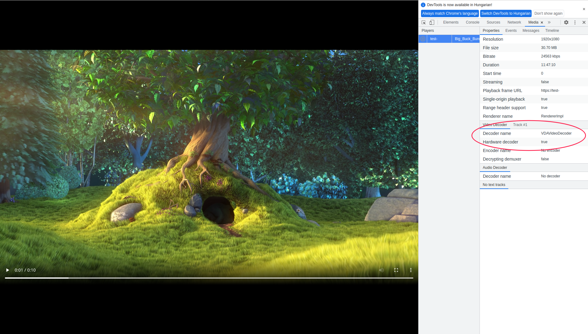

Now, your libva version is 2.14, it is enought that you able to run chrome with hardware decoding!
/opt/apps/cn.google.chrome/files/chrome --disable-features=UseChromeOSDirectVideoDecoder --enable-features=VaapiVideoDecoder

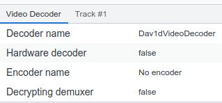

What is the content that you try to play it? Youtube?
2022-04-02 15:01
Vamp:
youtube和bilibili都不行,可能是不支持4代cpu
Vamp
2022-04-03 05:06
Default, youtube use VP9 codec. This decoder only support the modern Intel cards.
But one trick exist. All Youtube videos also exist with h.264 format, that most of cards are support.
With this extension, you force youtube, that use this type of decoder:
https://chrome.google.com/webstore/detail/h264ify/aleakchihdccplidncghkekgioiakgal
2022-04-03 15:45
Vamp:
可以了😄
