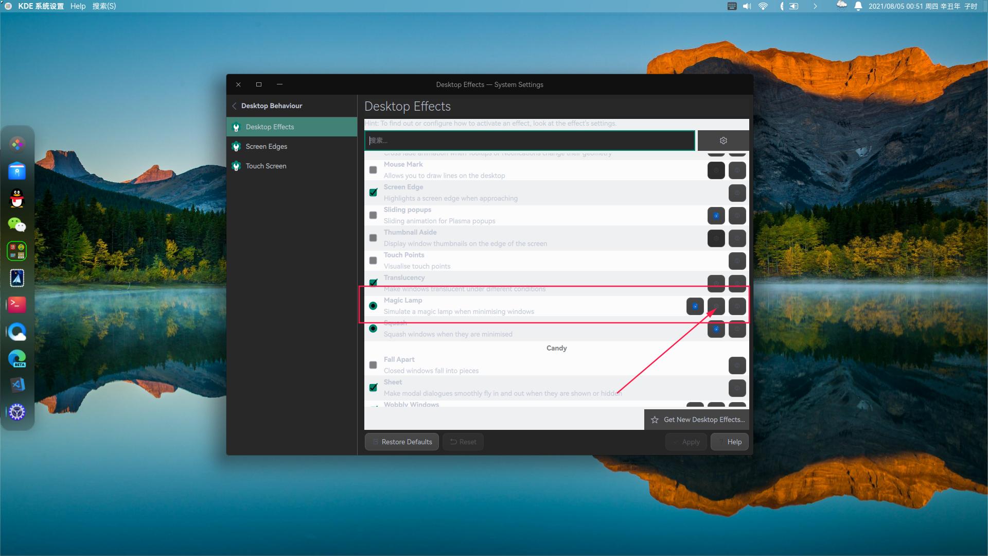

打击越
2021-08-05 08:53
c***v@gmail.com:
What has KDE System settings has to do with Deepin 20? Anyway, can you give a detailed explanation how to slow it down?
Because deepin's desktop is based on kwin!
sudo apt install systemsettings
c***v@gmail.com
2021-08-05 12:21
I agree on that, but why not such options in the Deepin Settings > Personalization is sort of a problem. Now, once systemsettings is installed, we have KDE 4 and 5 mixed up. Anyway, thanks for the tip. I'll play with systemsettings, just for fun.
In KDE Plasma, the Magic Lamp speed is about 700ms, but in Deepin, it has to be 1200ms to get the same movement. Not that I care for Magic Lamp, but the squashing when minimizing was terrible, hard on the eyes. :)
