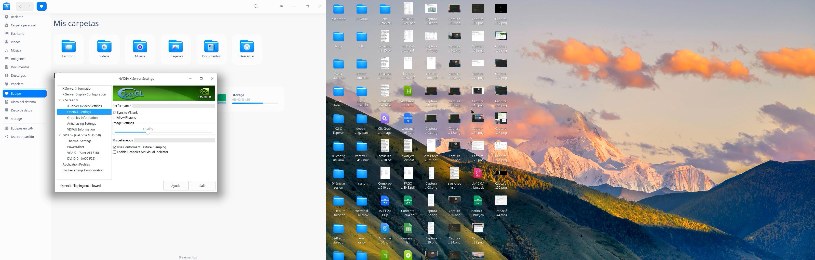

2021-06-19 12:18
The blur effect of the wallpaper does not work with Nvidia video card, instead of displaying the wallpaper with the effect blur, it showed a black background.
This time I am going to comment here, to see if I get any answers, but I don't have much hope that they will answer me.

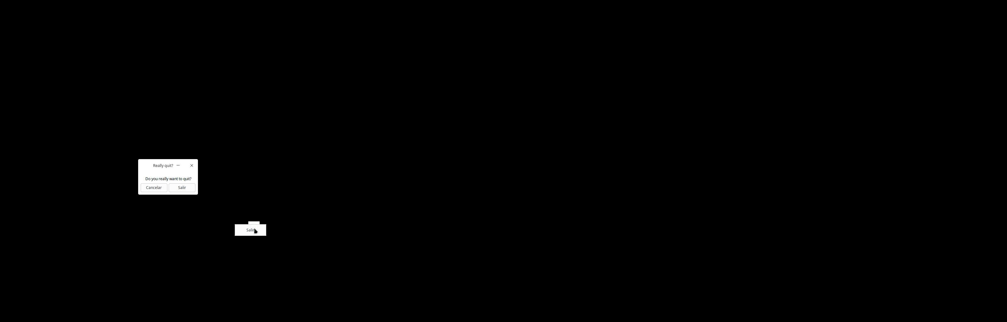

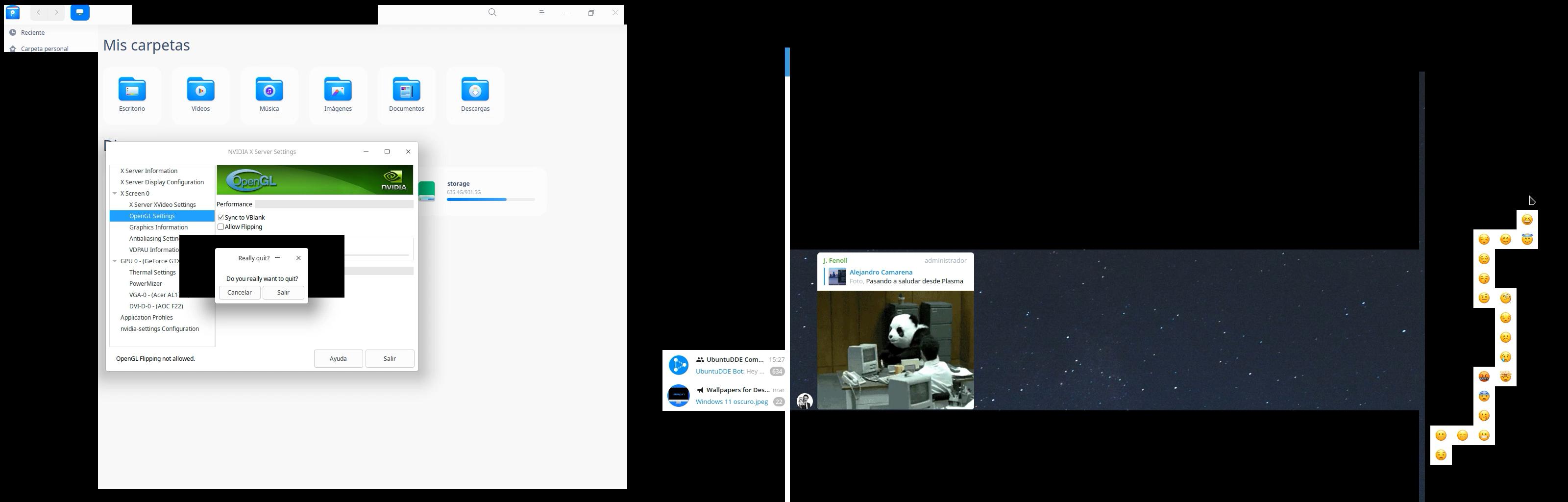

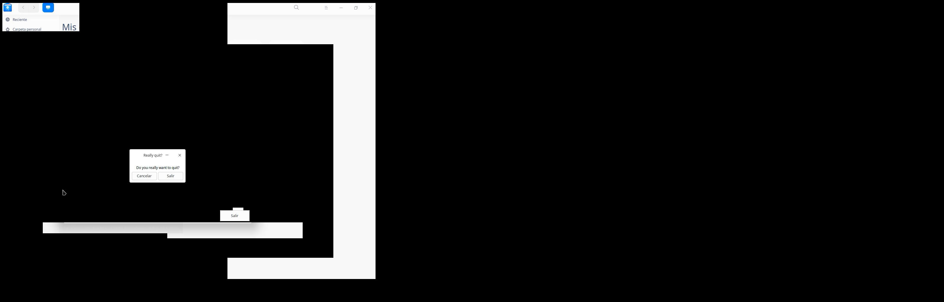

i***s@gmail.com
2021-06-20 15:07
With the Nvidia driver, after suspending the computer, when opening some windows, large regions of the screen go black, I think it is with GTK windows.
This does not happen when the computer is restarted or turned on, it only happens after suspending the computer.
If you want to send you the system logs and hardware details, it will be my pleasure. But since most of the time they have not even responded to me, generating the hardware report and the system logs has been a waste of time.
i***s@gmail.com
2021-06-20 15:23
i***s@gmail.com
2021-06-20 15:25
i***s@gmail.com:
The problem can be fixed by running the command
kwin --replace &
